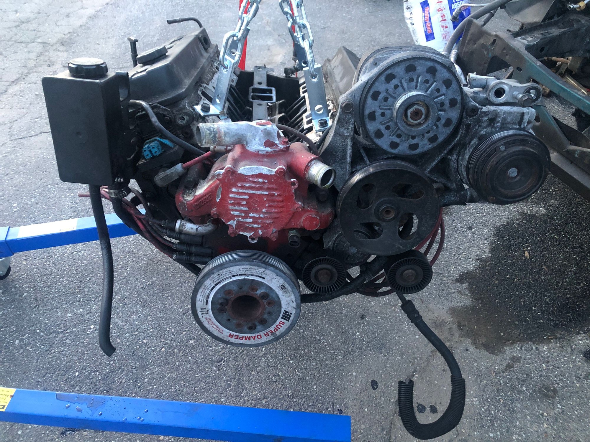

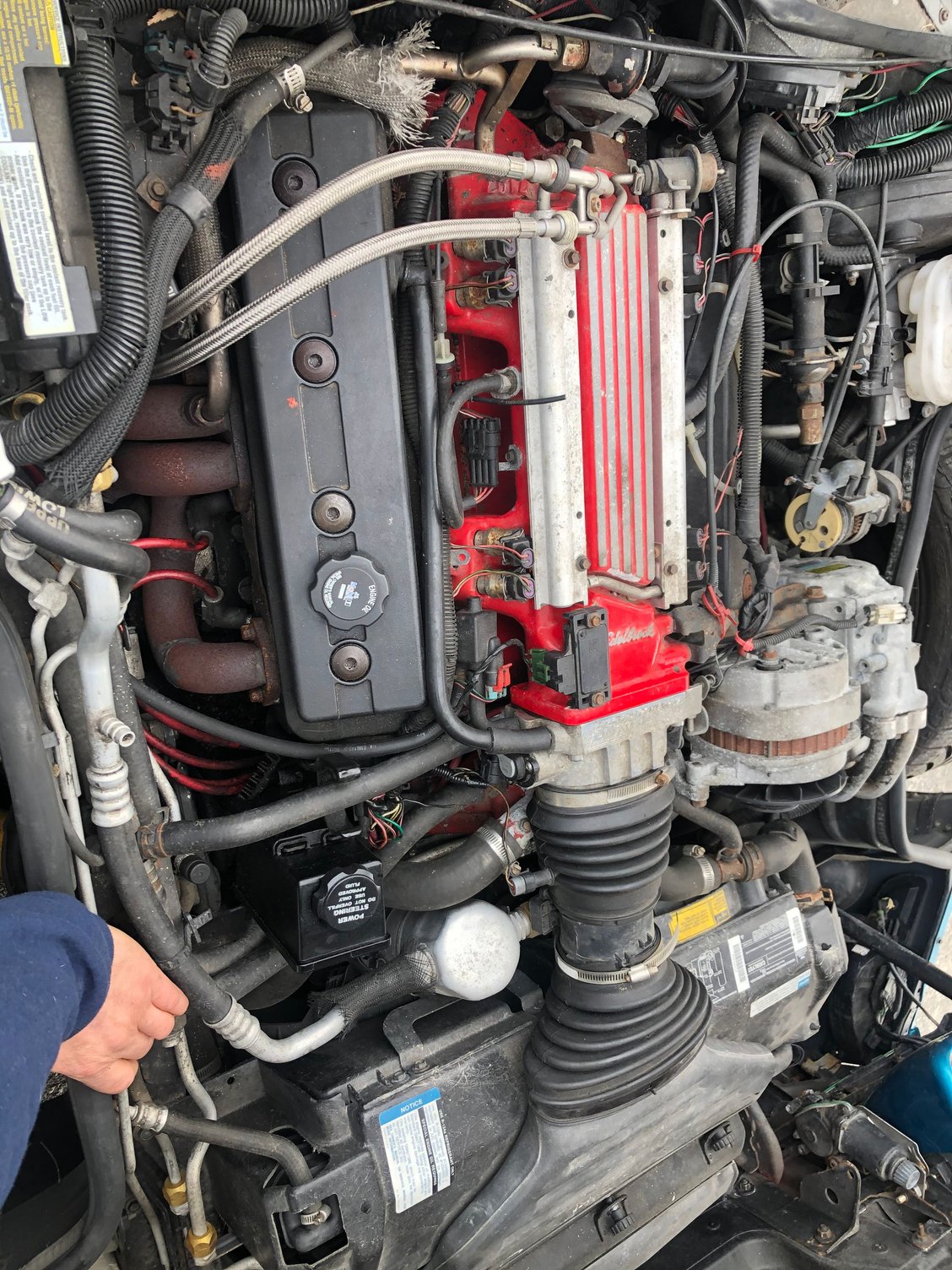

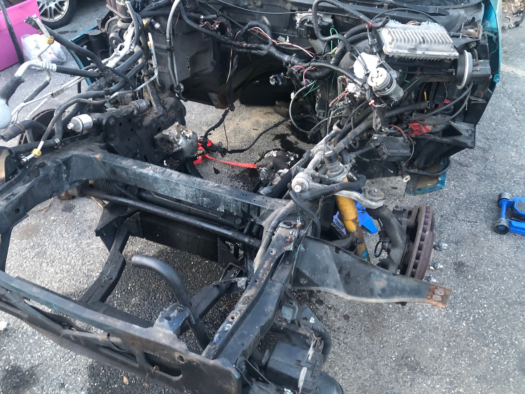

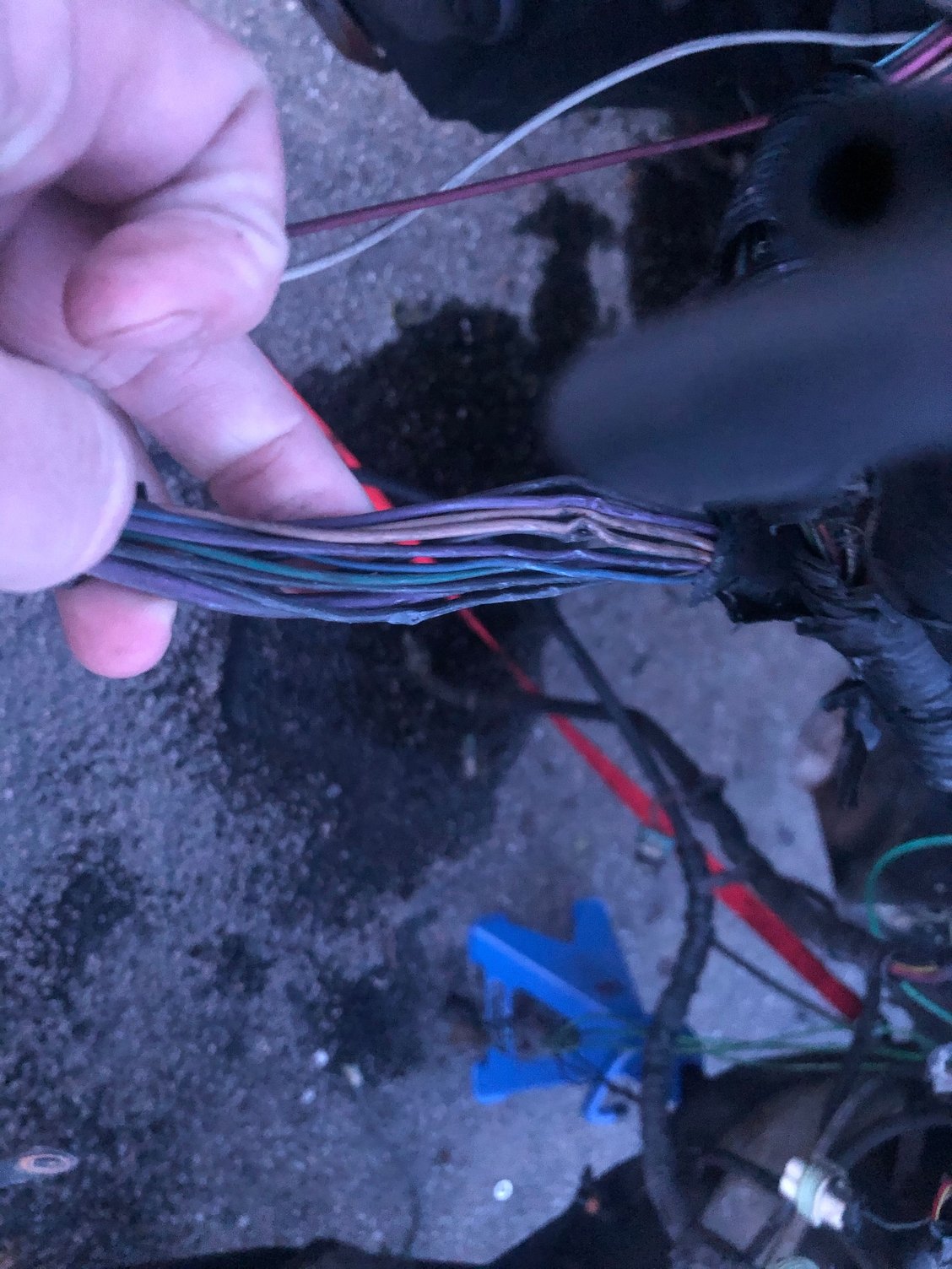

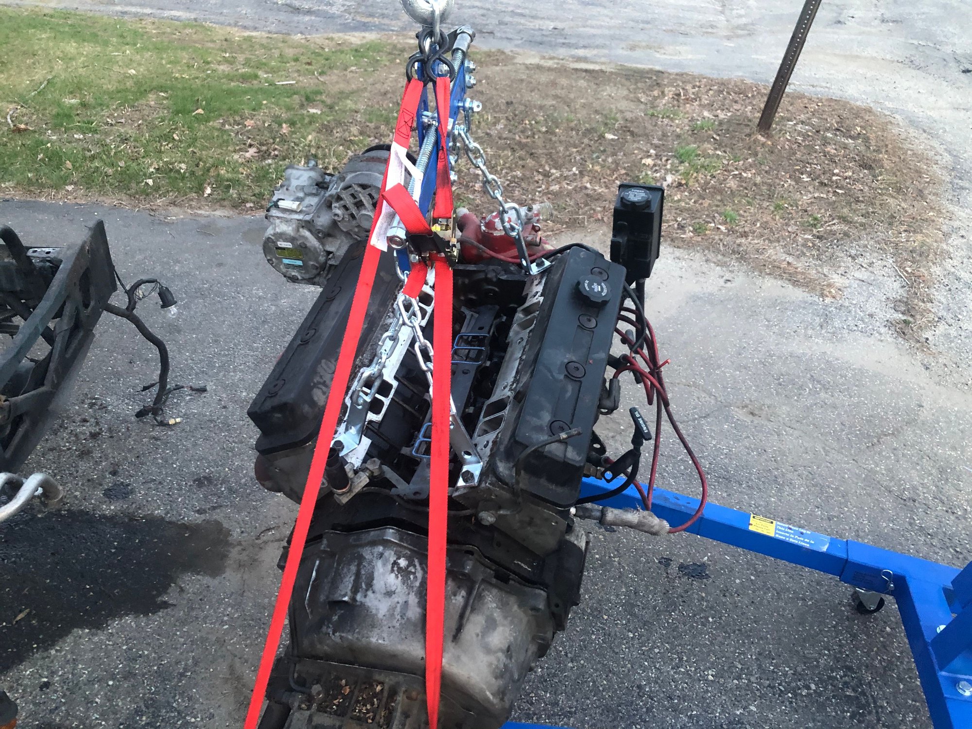

Just recently I bought a ‘94 from a fellow board member and after getting the car which was a project I decided to do a conversion. It has the Z07 option with J55 brakes. Cosmetically it needs loves but this post is more for the mechanical end of things. One question I do have is, can I get a conversion kit so I can retain the ZF transmission? I don’t really want to switch to the T56 if I can help it. Here’s some pics as it starts. At this point we were able to see a bunch of wires that were crimped, others that had hit the exhaust and started to melt. Right now the engine bay is a mess, but with the front of the car off, it’ll be easier to clean and do some repairs from a previous accident. The wiring harnesses will be cleaned up and we will omit any unneeded wires. I ordered an ecm for a 2001 so I can use a cable throttle body. The new engine started its life as a cast iron LQ9 that I’m having bored to 6.2. Right now I’m having trouble sourcing an adapter an input shaft for my ZF. I’ll update my post as progress is made
