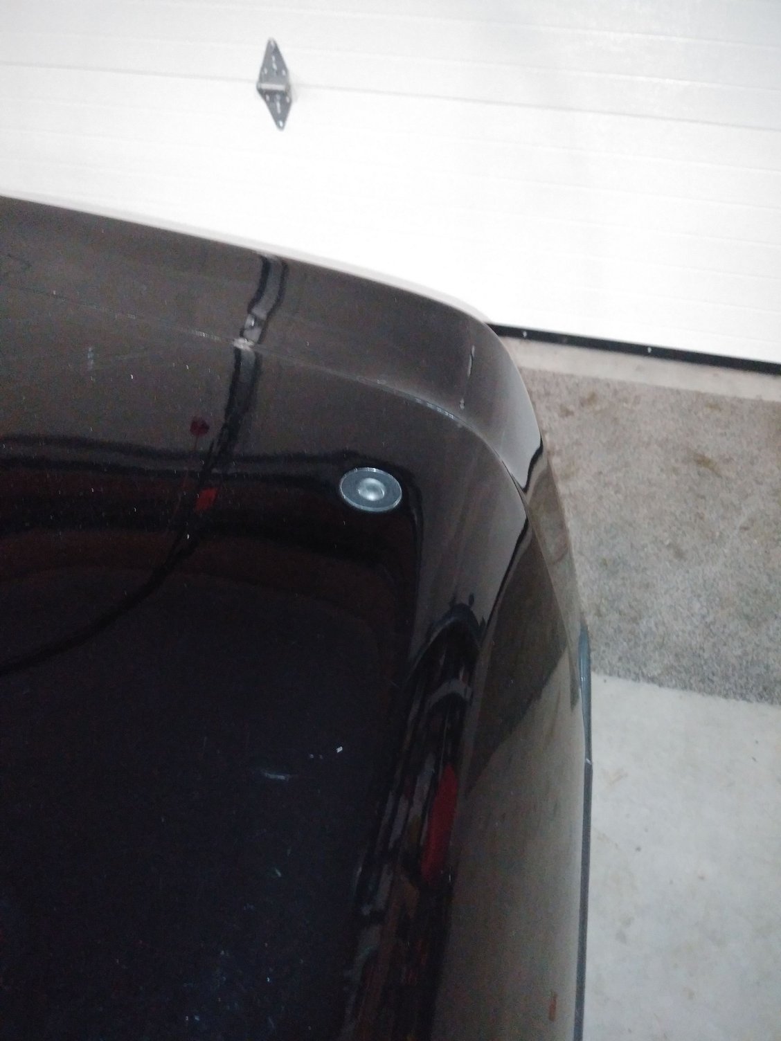

As far as what I've done with my car goes, it'll never need a power antenna replaced again, that's for sure!
Pic of antenna grommet:

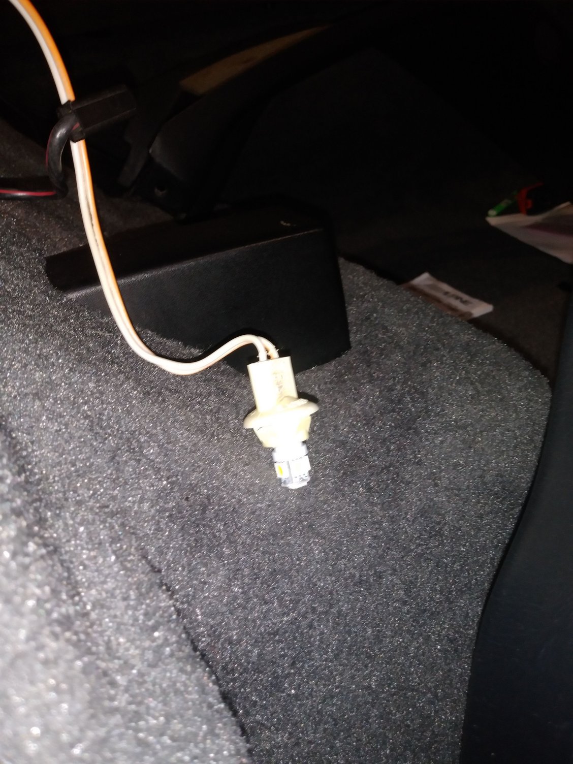

Oh look... I also offended the Corvette Originality Crowd by getting rid of the incandescents and replacing them with brighter, lower current draw, more reliable LED's... Which are a perfect example of the same outlook... Keep it OEM if it makes sense relative to FUNCTION, replace it with newer, better tech when it doesn't:
