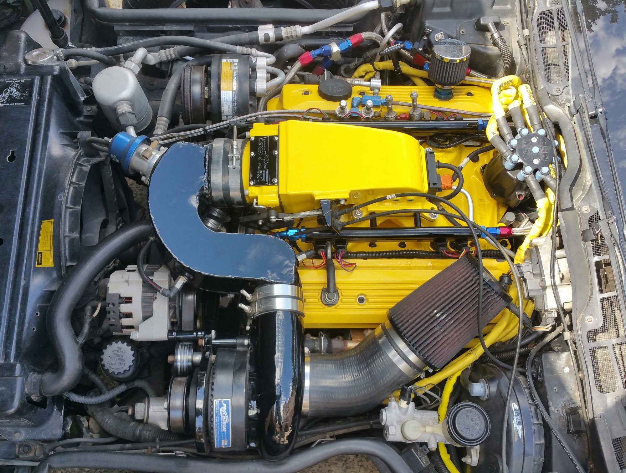

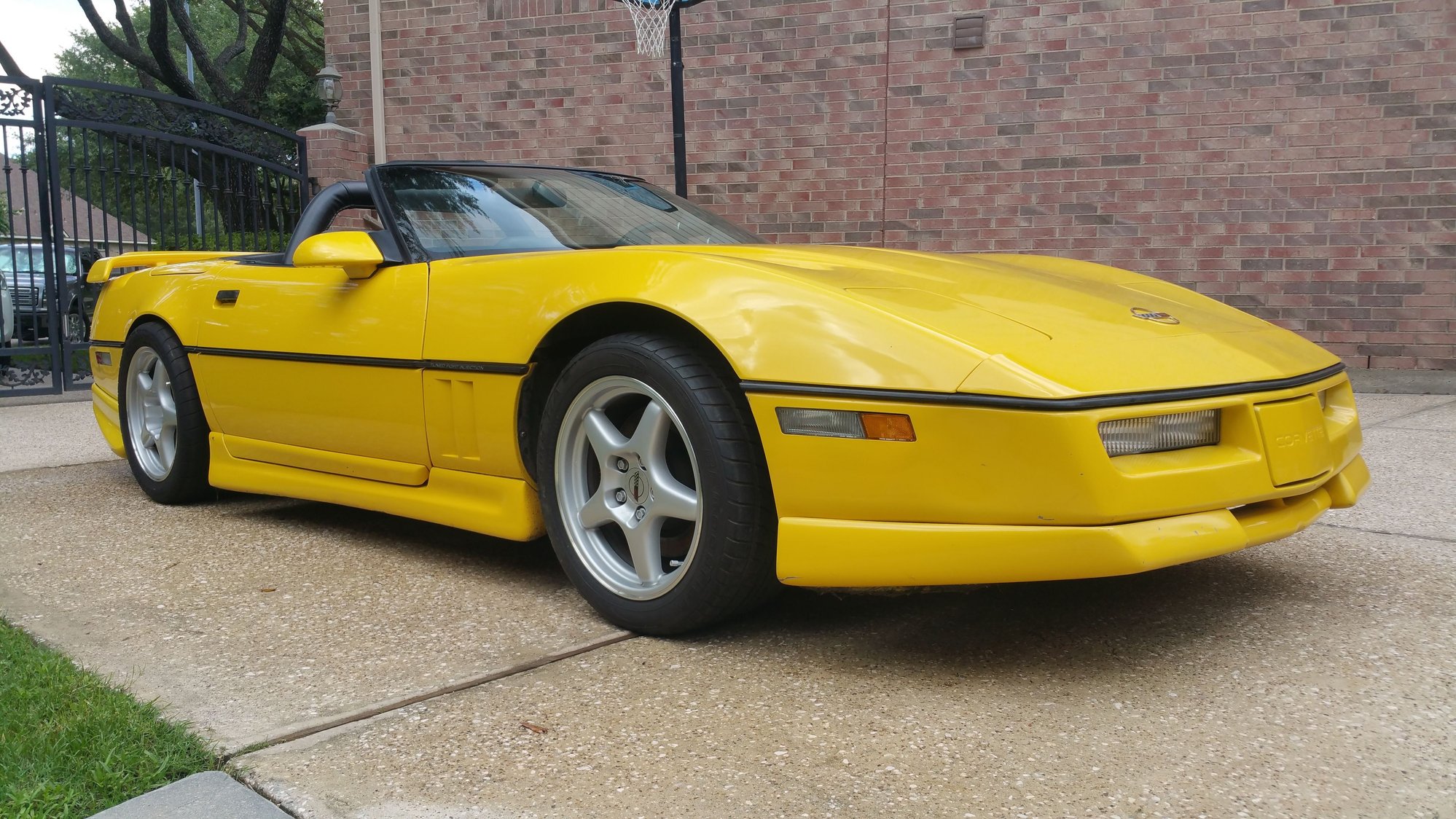

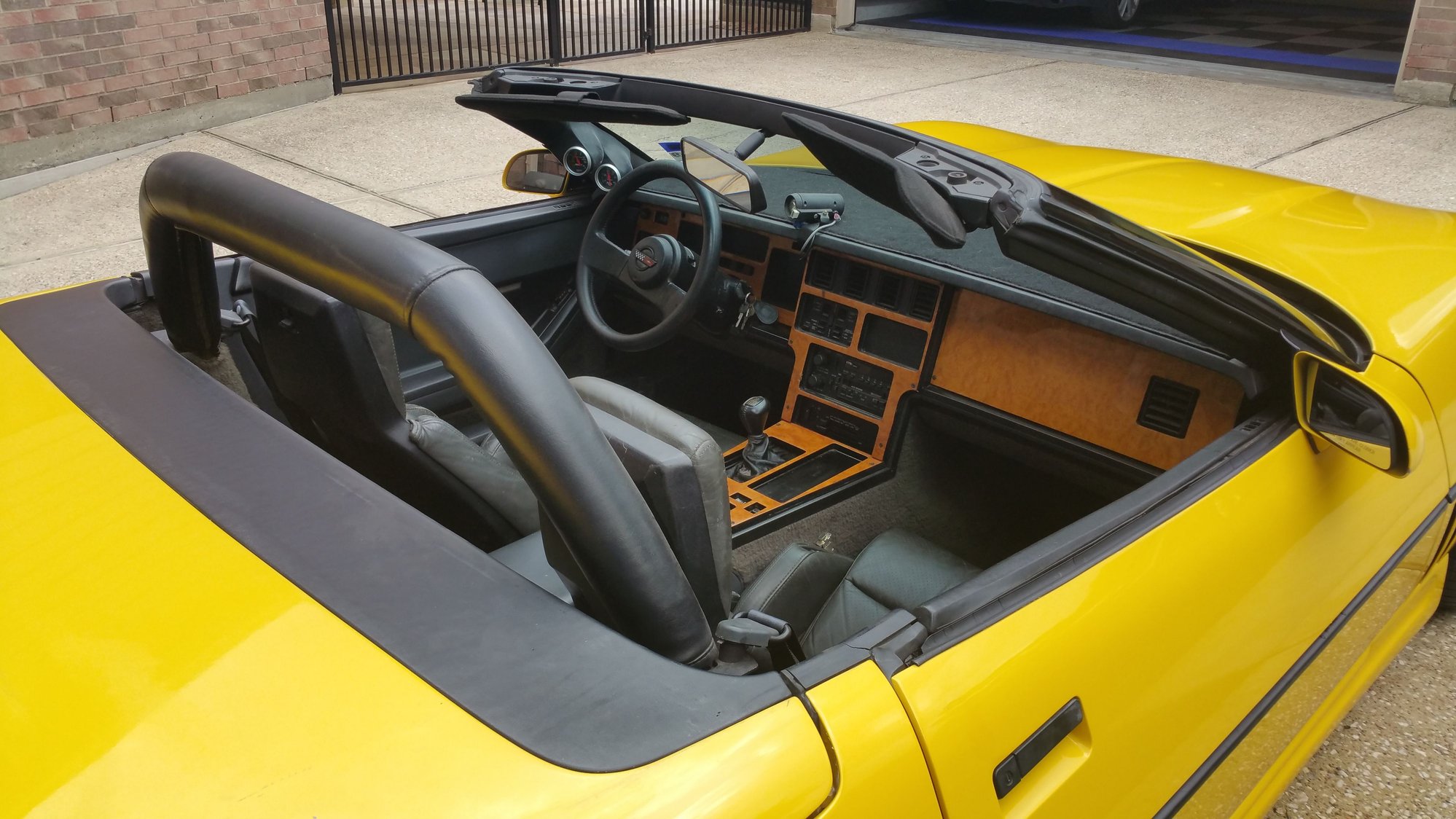

I used to be an avid poster on C4 Forced Induction and Nitrous threads under AFS_Racing. Here is "Miss Nasty".
1987 Corvette
1987 Corvette interior
Fully forged 408cid assembly, 4" stroke, splayed billet main caps, Oliver billet rods, JE Custom pistons, AFR220CP, solid roller cam, full Jesel valvetrain, converted single plane manifold, F1R, FAST Sequential, McLeod Twin, ZF, D44

What are you running for a fuel pump setup to support the power level with a supercharger?

I am running a tank sump with bottom feed to a Weldon pump. -12AN forward split to twin -8AN feeds to the rails. Single -8AN return to the tank post boost referenced regulator. Currently, it is running out of injector.

Named "Miss Nasty" on the streets, as I used to do a bunch of money races. With the hood down and windows rolled up, she looks like a well cared for, stock appearing C4. That is until she is started,...
