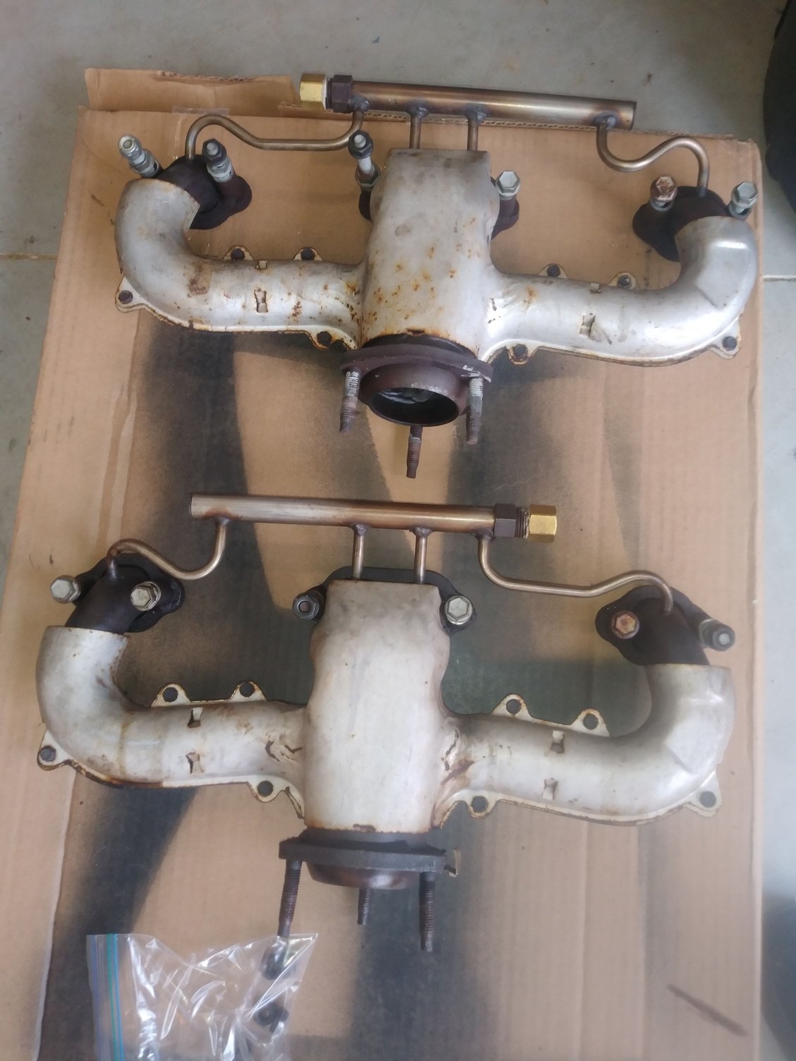

Demons, BEGONE:

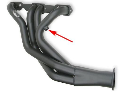

The Hooker headers for the C4 have the oxygen sensor on seventh header tube.
Probably so the position is the same as stock for emission compliance?
You should plan on having a muffler shop weld an oxygen sensor bung in the collector so you are sampling four cylinders and not just one.
You'll need a plug for the old fitting.
Just a heads up
Just a heads up
Thank you!
That makes perfect sense... I was looking at that and thinking that the bung was in the wrong place.
Why the hell they did that is beyond me.

Put the o2 sensor in the bung holley put on their headers unless you have the car tuned. The alternator bracket bolts right up, should have a spacer supplied with your headers, if not I recommend going to local hardware store and buying a sleeve the same length as the stock header has, you need to do the same for the bolt holding the dipstick. Last I knew hooker supplies all of those pieces with the headers. I bought mine second hand, guy wrecked his car before he got them installed, and lost the pieces by the time he sold the headers to me years after the fact. I removed the ac from my car, I live in the north and the car will not be daily driven, so removing 75 pounds was more important than having ac, plus maintenance is much easier with ac removed.

If you relocate the o2 bung to the collector you will need to convert to a heated o2 sensor, that's why the one that comes on the hooker headers is located
were it is so the stock non heated o2 can get up to proper temp.
