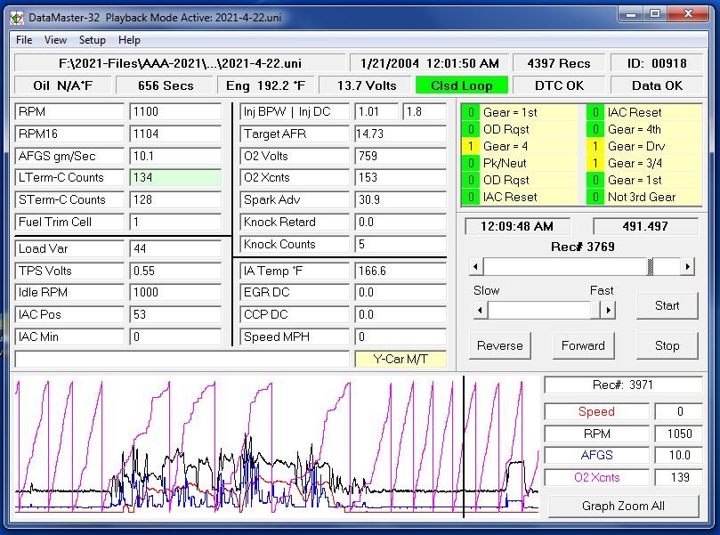

PacerX ... These are all good guy's giving you their opinion, all I can do is give you mine.
I'm in the process of tuning my new heads and manifold combination right now, 1988 ZZ4/L98, 32B code, hooker headers with the stock narrow band oxygen sensor welded in the collector.
No problem going closed loop right after a cold start and getting normal oxygen sensor cross counts.
I've been running the narrow band in these headers for 20+ years with no issues?
I have a wide band welded in the passenger side collector feeding a gauge.
Here is a startup and test run I just did this month, ignore the 1/21/2004 date, my ancient tuning laptop is frozen on that date because of a dead battery on the motherboard.
Don't know why others have issues with the stock sensor?
As I said, I believe there were other issues at play as well. Even on the stock exhaust the readout was lazy for a new sensor so I think there was something going on. It did work, just not great. I went most of the summer before it annoyed me enough to replace it so it really wasn't that bad. I did also find the fray in the harness around that point as well so it could've been that. I don't recall if I fixed that when I installed the heated unit or not.
I will agree, it should work fine. Mine did sometimes. Worst case is it doesn't. It's not a life altering modification that needs to be done at least.. fairly simple. I really don't get why it acted like it did.
