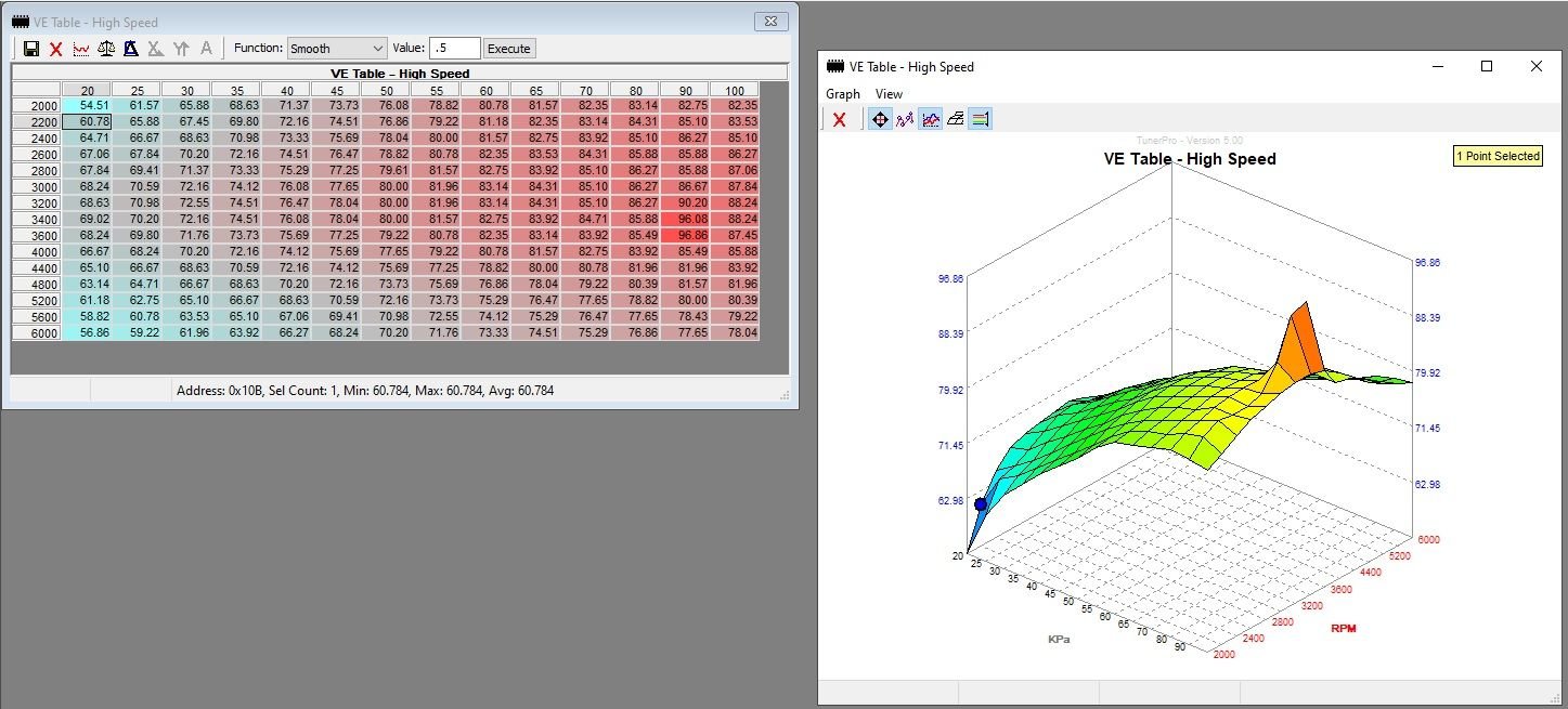

Ok WB02 installed...
I changed the settings you have listed above. I told WUD to VE learn via WB instead of BLM. I did a load in the 2000rpm range to hit as many spots as I could, and also took it for a drive about 2 miles down the road with RMPs from 750 - 3600 holding in each range with braking to catch as many points as possible. Right off the bat it changed the 600-1600 rpm and MAP 40-60 ranges a LOT in the VE Corrections, I had at least 15 spots with +10-15 point corrections. But I got up in the 200-3000rpm rages and hardly anything was changed at all. I flashed this BIN with changes and did another VE Learn session duplicating the route and another datalog. There were a few changes with -1 but not near as many as the session before. Here are the results.

When I do my wide band learns I force open loop and learn from the wide band.. open idle open cruise flags and let it go. Then it'll always read and not fight the BLMs. The way you did it also works fine but doing what I did it forces it to match the commanded AFR tables. I dont think it makes a difference.

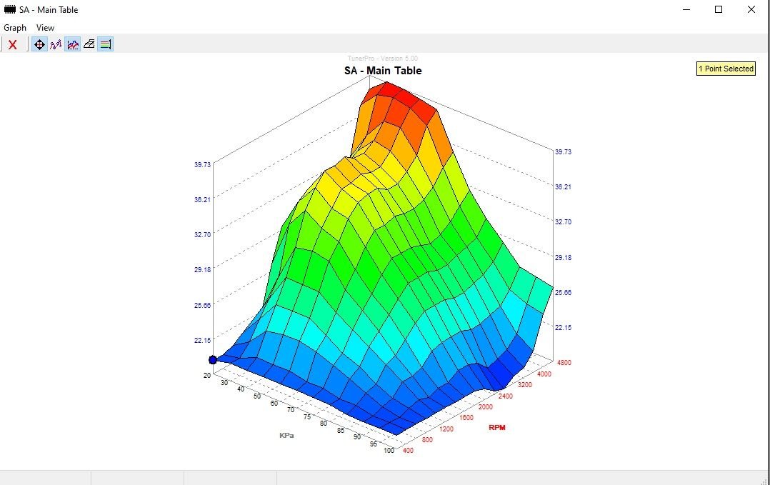

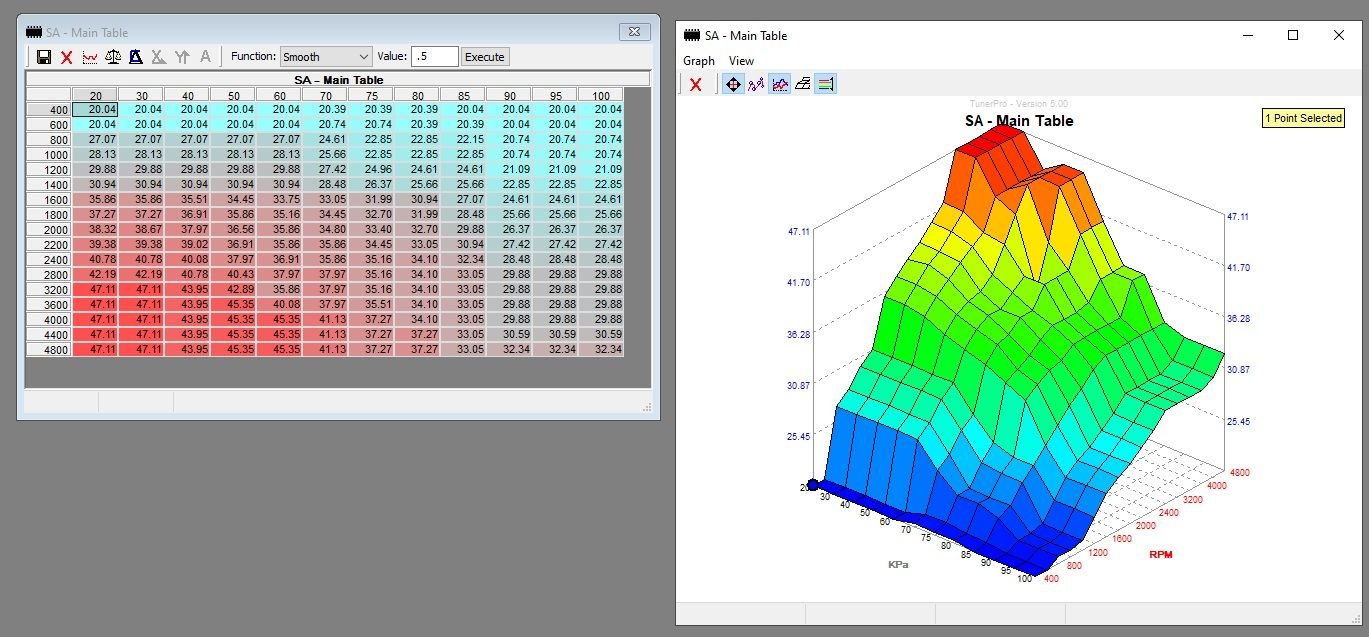

Ok New VE learn (number 34).. Pumped up and smoothed out the SA table also. Did my 4 miles run down the service road between 45-60mph various loads, then hit the Interstate coming back and ran up to 85mpg and 4500rpm steady. NO knock counts the whole time. It did add a couple of +9/10 at the bottom end.

1. This morning I set the "TPS - ADC Gain Term for TPS" value so I get 100% when WOT with KOEO as Street Lethal suggested in the thirdgen forums
2. The SA - MAIN Tables from a stock L98 were copied over to the EBL, this raised several cells at least 7-9 in value all around.
3. PE values put back into place.
Waited for engine to get up to temp (190degs) and took her for a spin trying to hit as many cells as I could and highway runs.
With steady throttle all the way to WOT I still had zero knock anywhere, I think I can bump another few degrees and see what she will take.
I see 1 big hick-up around the 34-3600rpm cells, will have to look at that on the VE table
The SA table looks much better then yesterday and she has more torque seat of the pants all around.
