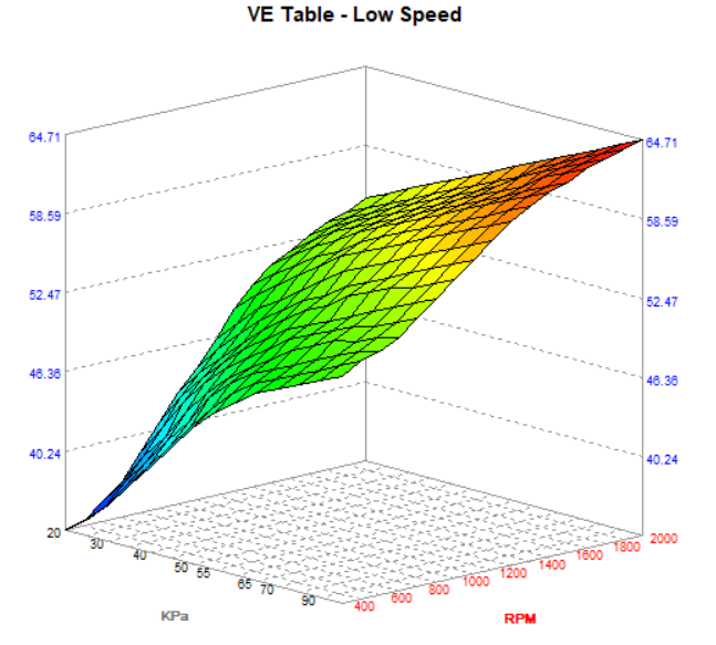

OK, so I use TP ver 4.16 vs 5, but that's only because I have been using ver 4 for so long and I'm ok with it. So, your high speed VE table looks odd to me with that huge bubble all in the middle. Is your motor bone stock? I also noticed your TPS gain was at 96, so just out of curiosity, when you have WUD pulled up, key ON, engine OFF what does the display read under TPS with gas pedal to the floor and held? Is it 100%? What is your BLM staying at?
Here is a pic of a bone stock 82/84 corvette VE table that was recently done notice the smooth transition between cells and on the high speed, they are somewhat close. BTW, my BS is in computer science as well and they didn't teach this in any class that I remember.

I don't see anything glaring. 89% tps key on engine off is probably fine, the voltage difference running makes up the perceived % difference.
The VE table looks okay, it seems to follow the torque peak on the runner tuning so I wouldn't be too worried about the hump, it is there on the EBL calibration for a TPI as well. What I would say is that timing in the areas you cruise at is very conservative... 35 degrees or so max. You can for sure sprinkle in a few more degrees and it'll be happier to run there and probably will help with fueling too... bin 3005 in the included files has a similar timing table with a few more degrees sprinkled in... I assume your cruise is in the 40-50 map range and around 2000rpms at 75? You are only seeing about 33 degrees in that area. I run almost 40 and the stock calibration in that range is 38. I'd suspect that would have a meaningful effect. Maybe try that.
