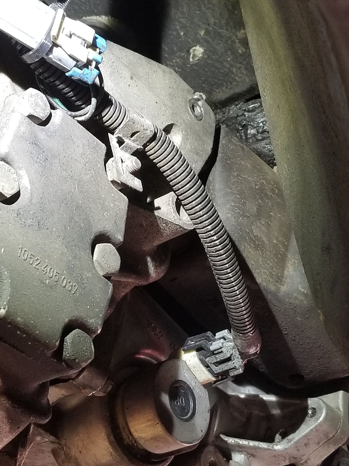

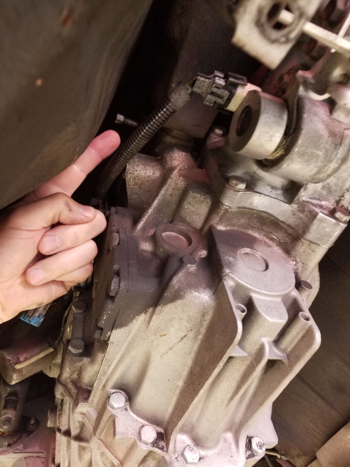

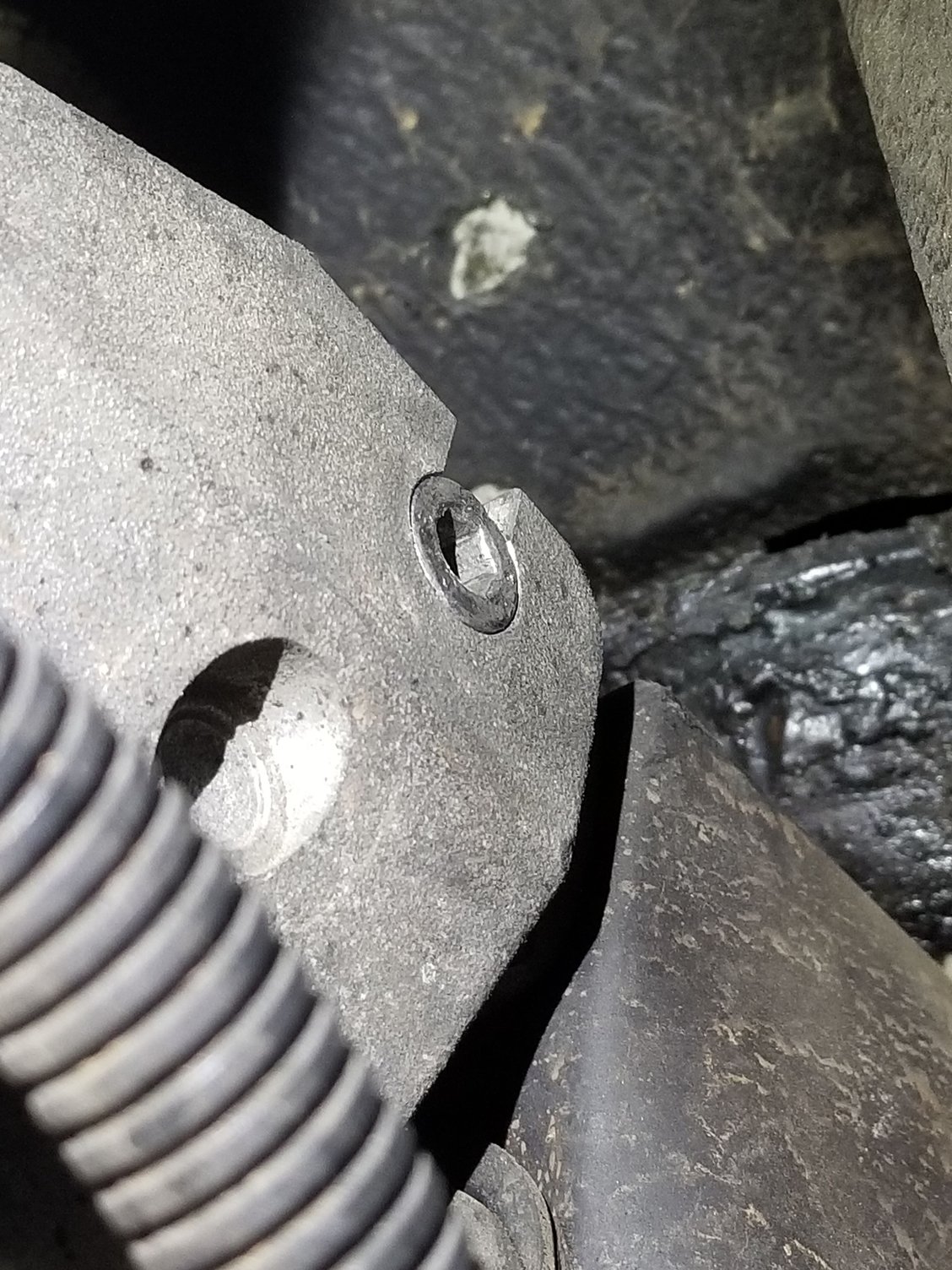

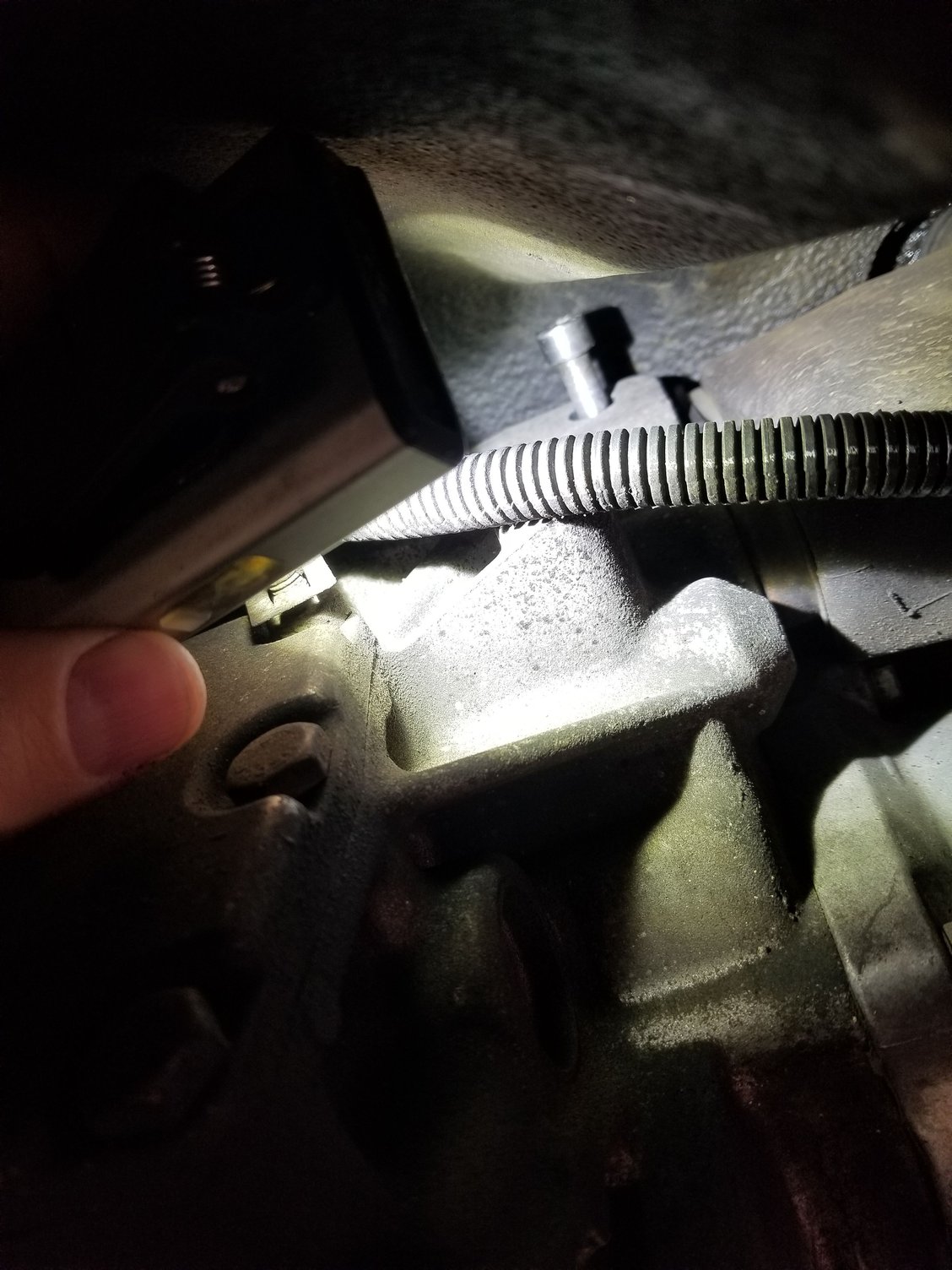

Yeah....I"ll get to it, "this weekend". A year later, I've found A loose bolt. I can't get the threads to "take". I think I'll have to lower the trans to see what's up.

Incredible. Murphy's law. Sooo close. You can touch that Allen bolt.
If only. threaded 1/2" more.
you could sneak in a 1/4 bit. i believe that is a 6mm hex. spin the bit with a gear wrench.

Got it.
I wasn't sure what I was "aiming for", so I wasn't hitting the hole. Dropped the C-beam....excuse me, the "Driveline Support beam", and lowered teh trans, then realized that I had to manipulate the shifter housing/assy to get the bolt to line up w/the threaded hole. Then, w/the trans down, easy in!
