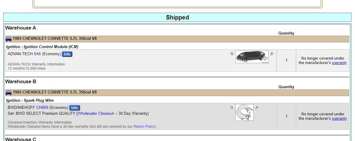

I bought this one and it works then I saved the old one. I use arctic silver 5 paste(for cpu's) under it .
From Rock Auto
