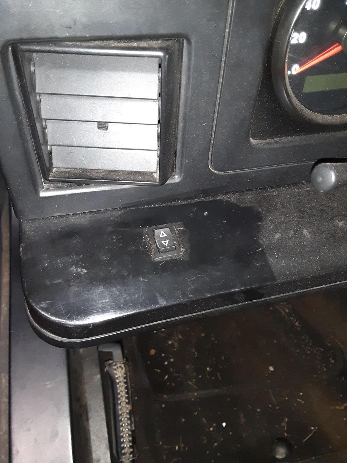

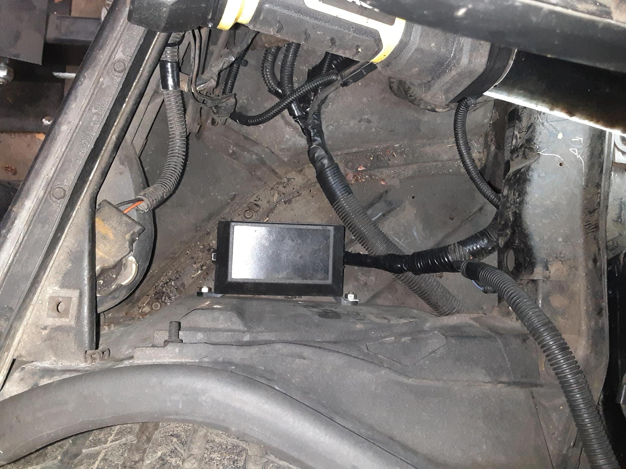

Roadkill,
Judging by your user name you might like the way I repaired the same issue in my 84. At some point the previous owner had hacked in two wire headlight motors instead of the three wire versions that were supposed to be there. This conversion wasn't done very well and it led to a bad drain on the battery. That and the lights would just work when they wanted to. So I put in a small rocker switch and a relay box that I got off ebay.
So I removed all the factory relays and threw them away. Then I started from scratch. So the toggle switch raises and lowers the light buckets just like power windows. The factory pull switch turns the bulbs on and off. In the last picture you can see how I have it labeled. One 5 pin relay for lights up and another for down. One 4 pin for bulbs on low and another for high beam. Then the brown one is a 4 pin I used for the fog lights. The whole thing cost about $40 and it works every time.
