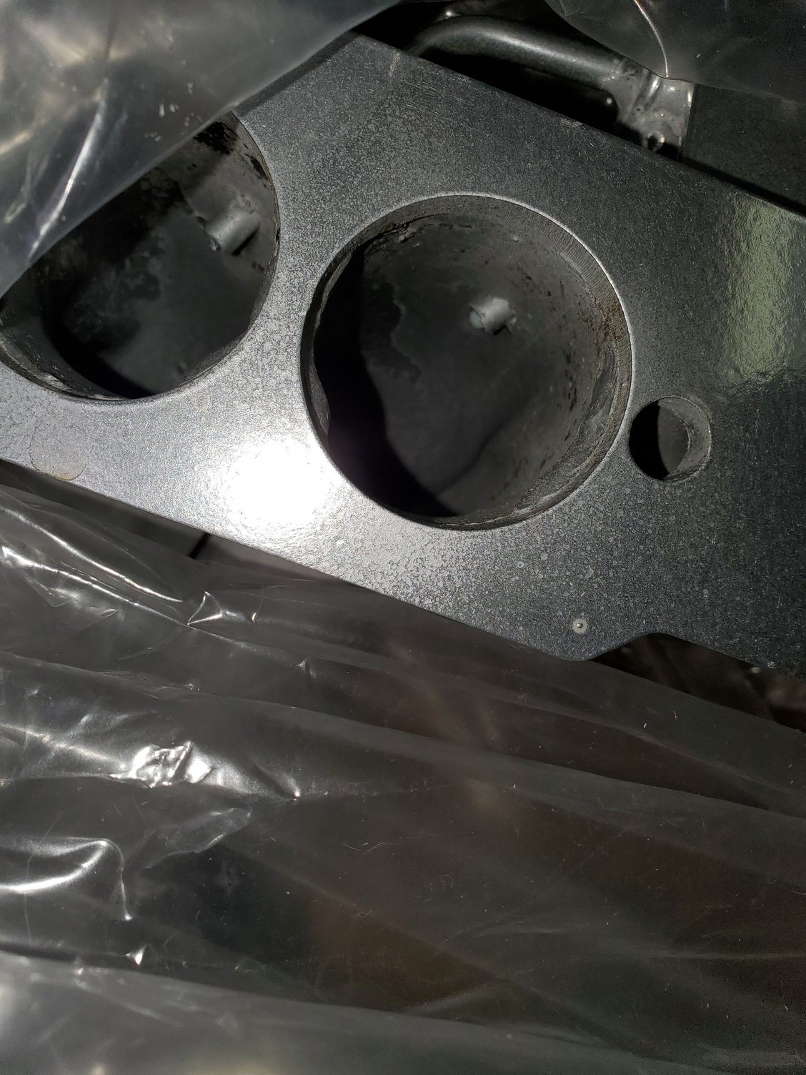

Remember, I ordered mine in early December and received them on June 7th. I don't believe the inside is coated. I'll post a pic.
Old Jun 18, 2021 | 03:25 PM
bartenderfloyd's Avatar
bartenderfloyd
Joined: Jun 2019
Posts: 147
Likes: 48
From: Rockland County, New York
