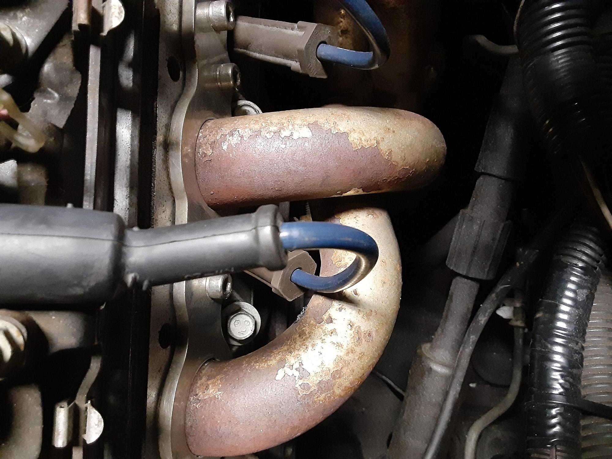

I'm trying to figure out why I have such bad luck with ceramic coatings? This is a picture of the headers that are on my car right now. They are Jet-Hot coated inside and out.
They looked like this after a year. I've had two different sets of stainless headers now with a wrap on them. I've never seen a stainless header rust with or without a wrap. i'm so fed up with ceramic coatings I'll never have one again.
