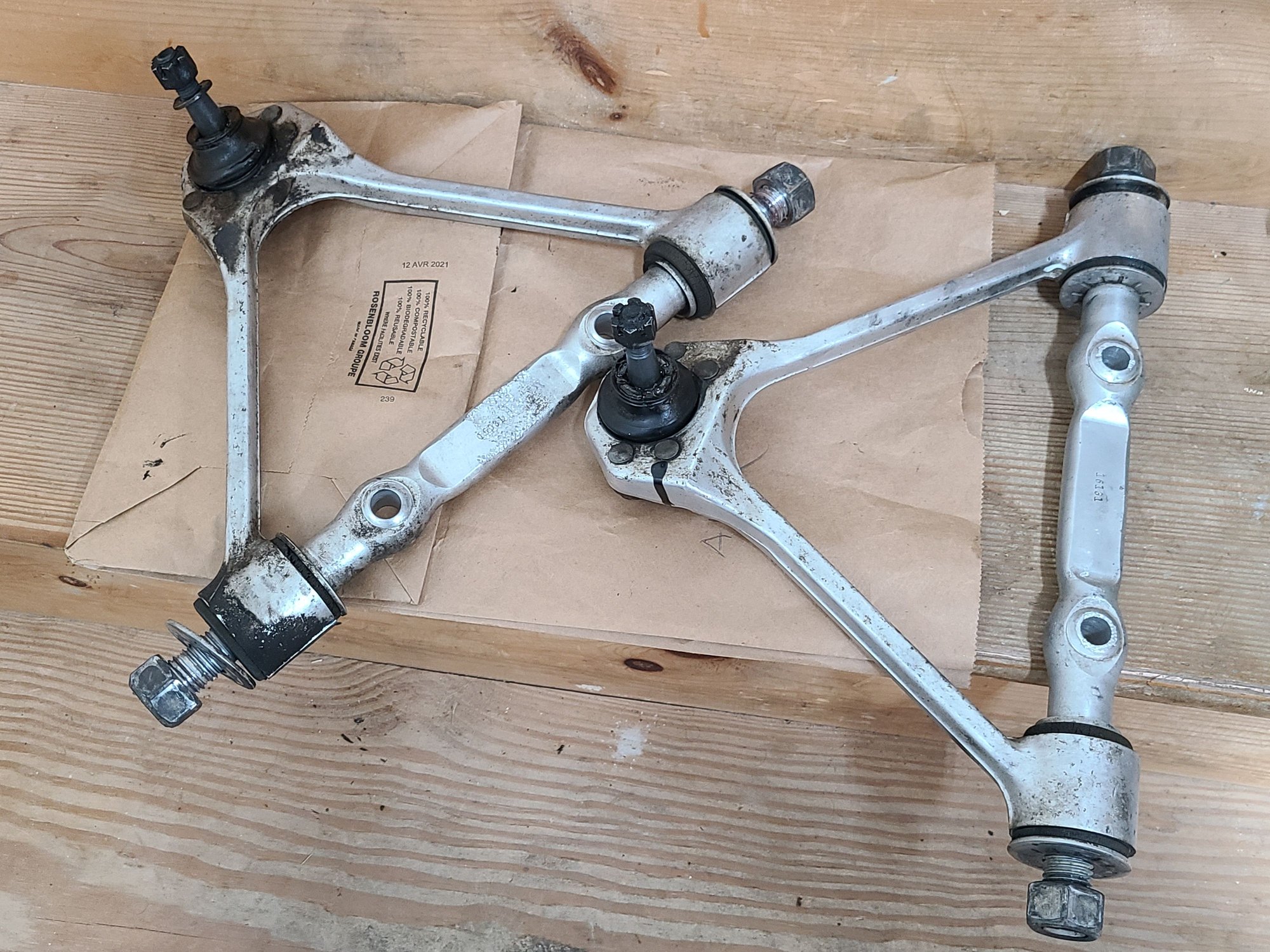

Haha about the joke....I always try to look at these projects as fun times....lol...otherwise I would start doing this.......lol.....right now my biggest concern is getting the end nuts off of the upper control arms.....my electric impact...although strong...is not strong enough to move them ....need to either go out to my friends garage or find someone local with an air impact....my small air compressors would not be strong enough for them....
use heat to help melt the thread locker.
I would be careful with a impact as they are aluminum threads tighten to about45 ft lbs.

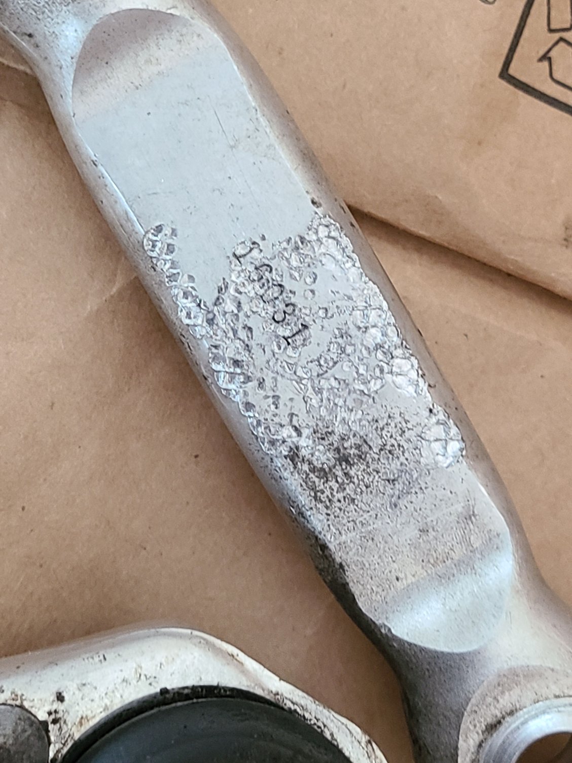

Went to the local tire store and got the nuts removed from the uppers... saved me a lot of aggravation....as I don't have the strength anymore... plus the air wrench did not do the job completely as he also used a breaker bar in-between the air wrench and finally got them done...took all about 15 minutes... In the second pic you can see the marks from the vise....even though that part is not totally visible when installed....what type of sanding would you do to eliminate some of those marks???
Suprised they were that tight... mine busted right off with an electric with no heat...
For the marring... I'd probably just hit it with a wire wheel perhaps?

My electric would not budge them....they had the red loctite on them from the factory....I peeled some off inside one of the nuts today....will have to go through them all....and will reinstall with blue loctite instead of the red.....have had some good suggestions for the marring.....will try them out and see what works the best.....
