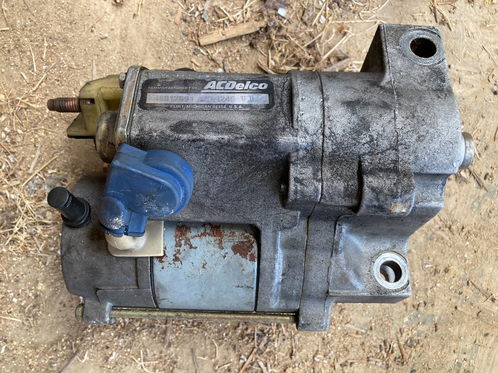

The one that came out of mine is definitely a reman. Picture below of the only label. Yes, my bad, the number is cast, not stamped on the drive-end housing.
The issue with this starter is that it appears that the bendix started going out. Now and then I when I would go to start it, I'd get the awful gear clash a time or two until it would engage properly. After about ten times, I replaced it since it's cheaper/easier than a flywheel. :-)
