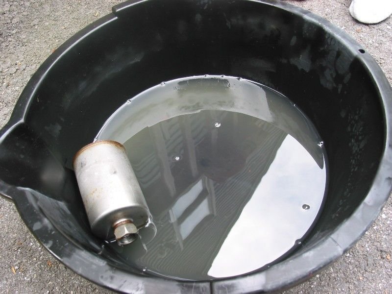

1. The fuel system remains under pressure even after the engine has been shut off for an extended time. Therefore it is necessary to relieve the pressure in the fuel system before any work is done on fuel injection components or lines.
2. Remove the cover from the fuse block located in the right end of the dashboard.
3. Pull the fuel pump fuse from the fuse block to disable the pump. The fuel pump fuse is identified by the letters FP.
4. Start the engine and let it run until it dies from lack of fuel, then crank the engine over for several seconds with the starter to insure that all pressure has been eliminated from the system.
5. Be sure to replace the fuel pump fuse when work is completed on the fuel system.
After the fuel pressure has been relieved. it's a good idea to lay a shop towel over any fuel connection to be disassembled, to absorb the residual fuel that may leak out when servicing the fuel system. I found on my 96 the fuel continued to leak out during the entire fuel filter assembly. By time I was done I had this much in my oil pan.
