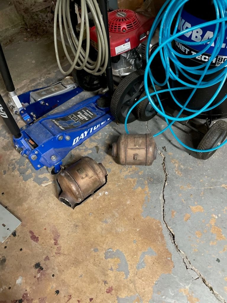

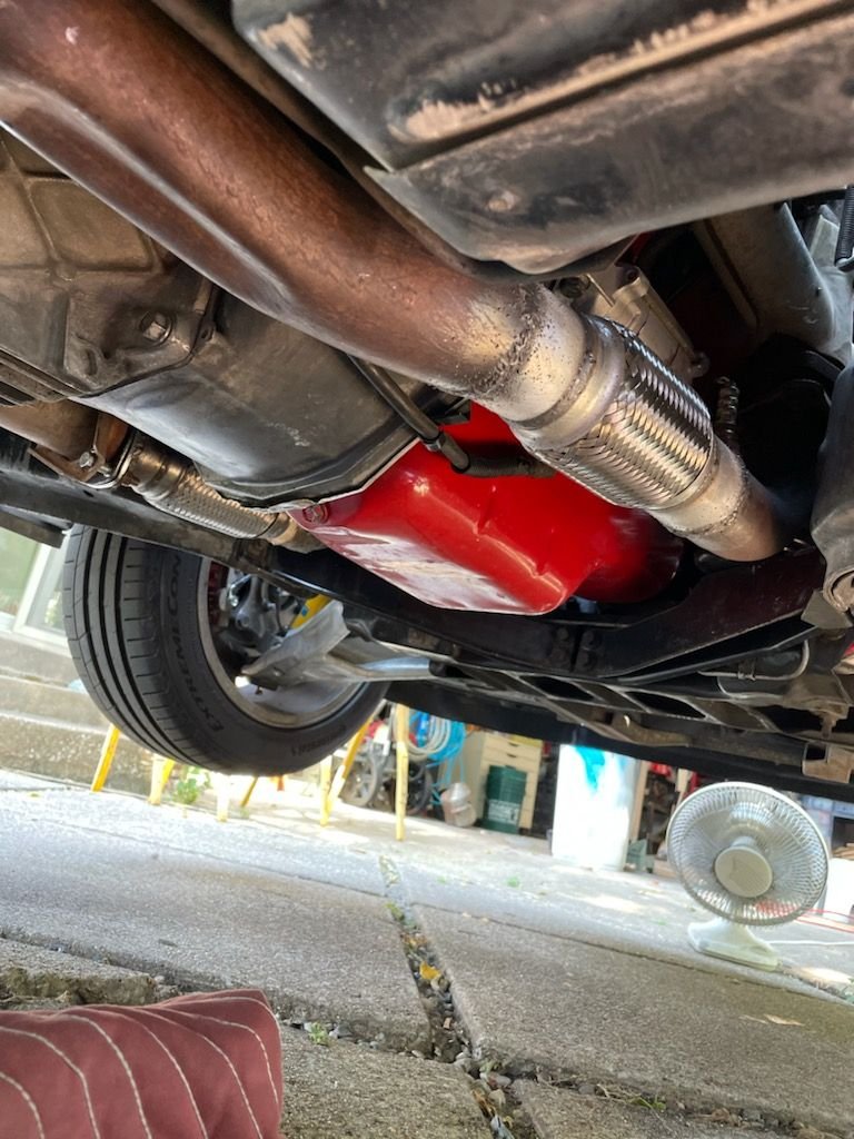

I had my cats take a dump last week. I am cutting them out myself and putting in a patch pipe for now. No shop around here would delete due to the car coming with the cats from the factory. I had to learn how to wire weld this week. Its not pretty but its not leaking, for now. This is not an expense I am ready to take on now....ugh...sometimes the car has different ideas.

My car is an LT4 6sp, rebuilt engine with GM Hot cam, 525 lift at .218 duration. Sounds good, good power. Previous owner removed the stock mufflers from the rear of the car leaving only the main muffler under the car and the cats just after the manifolds. I decided to remove them instead of gut them because access inside the passenger one was very limited and I didn't know how I would open that up and clear it out. I cut them out and welded in flex/repair pipes in their place. To do this repair I had to learn how to weld. I had some HF tools I didn't ever use so I took them back and I had to ill fated Pittsburg jack stands that went back as well and got myself a small 125 Fluxcore wire welder. That was an adventure. Youtube to the rescue. I managed to get the pipes in place and welded. It doesn't look pretty but they don't leak and I got a wire welder out of it. Never hurts to have one of those around.
