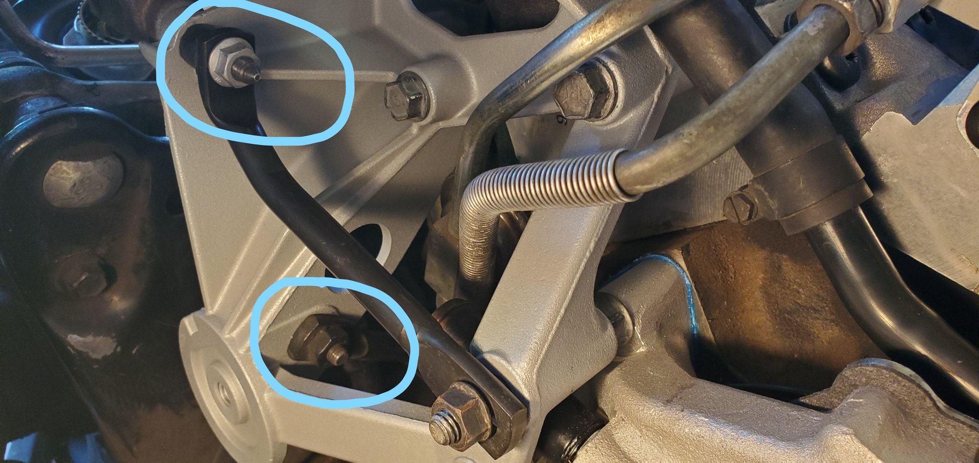

On (some) 1989s there are two steel strengthening braces that were added in addition to the A/C compressor mount itself. If they are missing, or not bolted up correctly on your car, this could be a contributing factor but I don't think it would cause the issue with the compressor itself, just potentially make it worse. They're circled in this photo which looks down from the top center of the radiator towards the passenger side front of the engine.
It sounds like a compressor issue to me but I'm not there seeing/hearing it. The lack of the frisbee could make the issue more visible since it's a flywheel designed to dampen out vibrations in the belt. But, if these braces are either missing or not bolted on correctly, in my mind that could potentially cause a weakness or vibration fatigue crack in the main aluminum compressor mount. Maybe.
Take a look and see if your braces are good...
Both braces are there.
