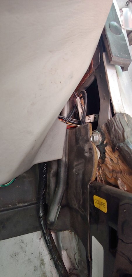

Anyone know why there is a drain tube inside the car against the forward
Up against the passenger 'A' pillar, under dash????? Where does this come from???
right side, up under the dash?????
It flooded my car yesterday. Sure the Targa top drips, but not 2" of WATER on the passenger floorboard!!!!

I put a hose into the drain tube and blew smoke into it and it came out the underhood cowl, fresh air intake. not sure why it would drain into the car, but now I have to figure it out. I can't have rain water draining from the cowl into the passenger bucket. SHeesh.
Thanks for the guess though.

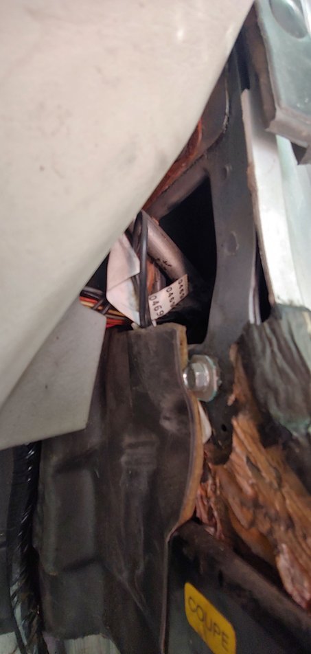

I guess the car has been painted and someone must have been in here, because the drain tube has silver paint on it. I took a pic of where it was, pulled it up and shoved it down into the 'A' pillar. Hopefully that will take the water out. I'll test it. But this definitely was the problem.

None were clogged. Its just that the passenger side drain tube was not stuffed into the 'A' pillar.
After routing it properly, I did test it and the water does NOW drain out behind the right side fender lower panel.
