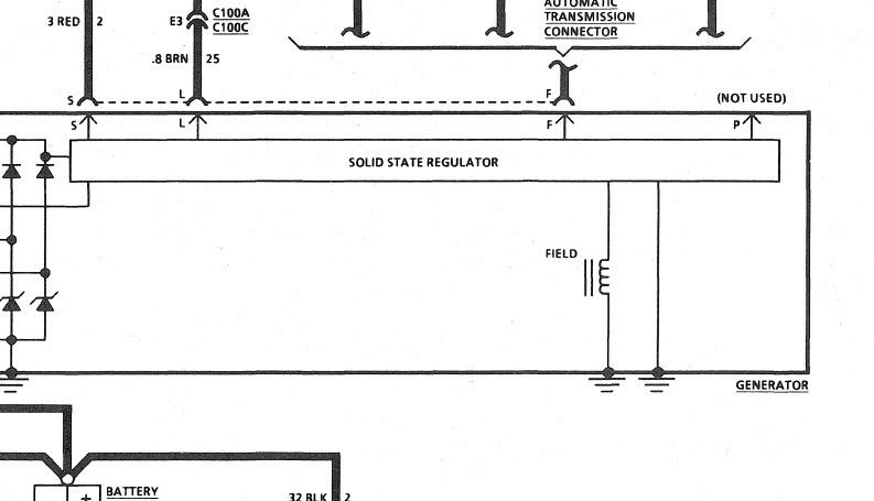

I was replacing my alternator on my 1994 corvette and i broke the plug that plugs into the alternator. Well stupid me i cut the wire to splice them into my new connector. Now problem is the wires coming from the car are both brown. What will happen if I connect them wrong. And how can i find out which wire goes where to my new plug. Wires on my new plug are multicoloured.

If you bought a correct 'pigtail' - it should be marked P - F - L - S The alternator also should be marked I'd think, Match P - F - L - S. On a '94 I doubt that P is used, L and F are both brown I believe.. This I believe should be correct on the alternator.
