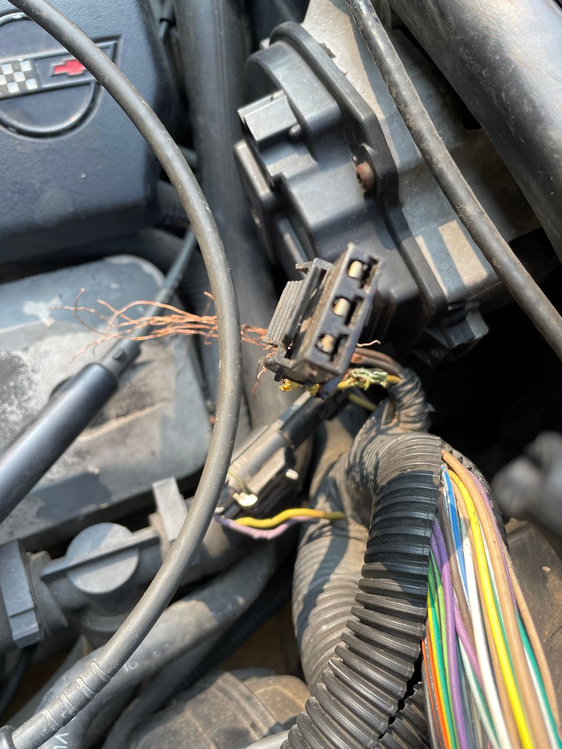

Good morning group,
Can anyone tell me where I can find a connector (see attached photos) for my windshield wiper motor/controller? Mine were shorted out this past Winter by some creature looking for warmth.
thanks for any advice

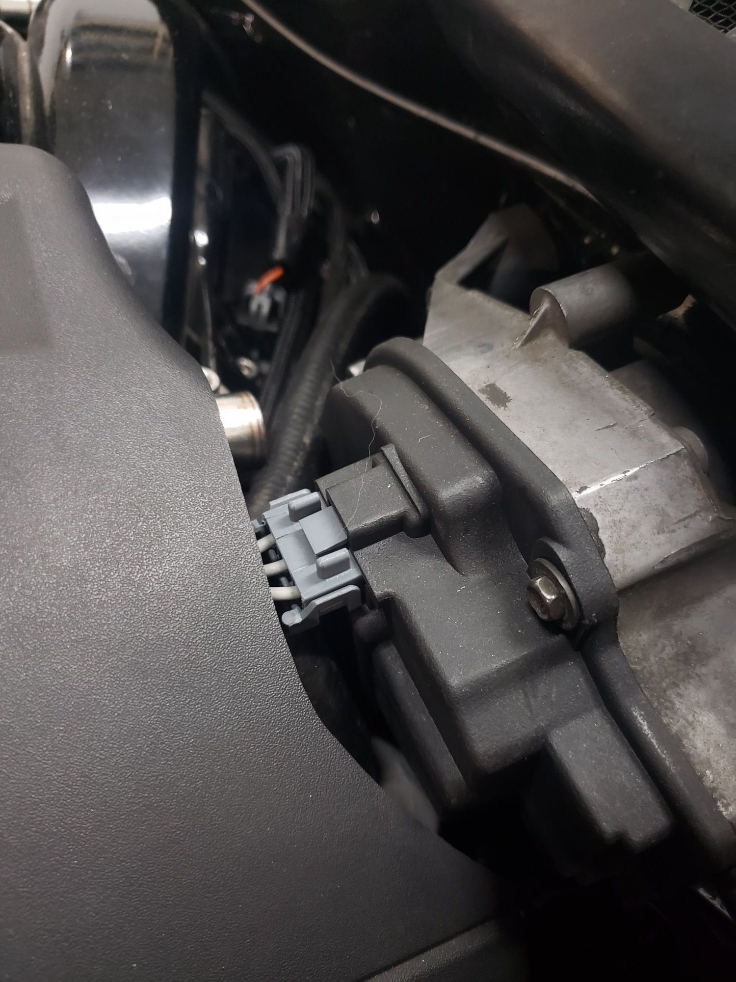

An ACD PT335/GM 12102668 will require minor modification to work. The original from GM was only an empty connector that you needed to add terminals and assemble. That was a 12020014. BWD and others should have an equivalent to the ACD/GM that should be available locally and also less expensive. It's been used by some here for a correction. This is an installed snapshot of it's use.
@DMITTZ David Mitten supplied the snapshot of it's use and I believe he used a BWD equivalent rather than the ACD/GM. Availability might depend much on your location.
