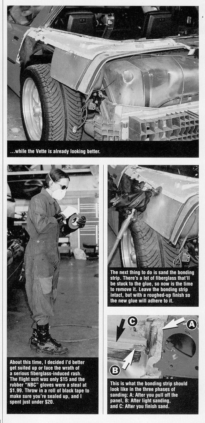

I've searched and haven't really found much detail on how to remove - and replace - a rear quarter panel,
My LR is damaged and if it's easier I'd rather remove the old one vs. try my hand at the repair. Part of the damage is to the left of the gas filler where the quarter panel meets the rear bumper cover. Also a 6 inch or so crack just below the anntena about an inch in from where the quarter and rear bumper cover meet.
I already have the bumper off to replace it.
Is there any source better than another for a replacement quarter?
TIA..

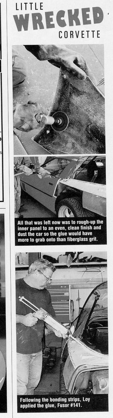

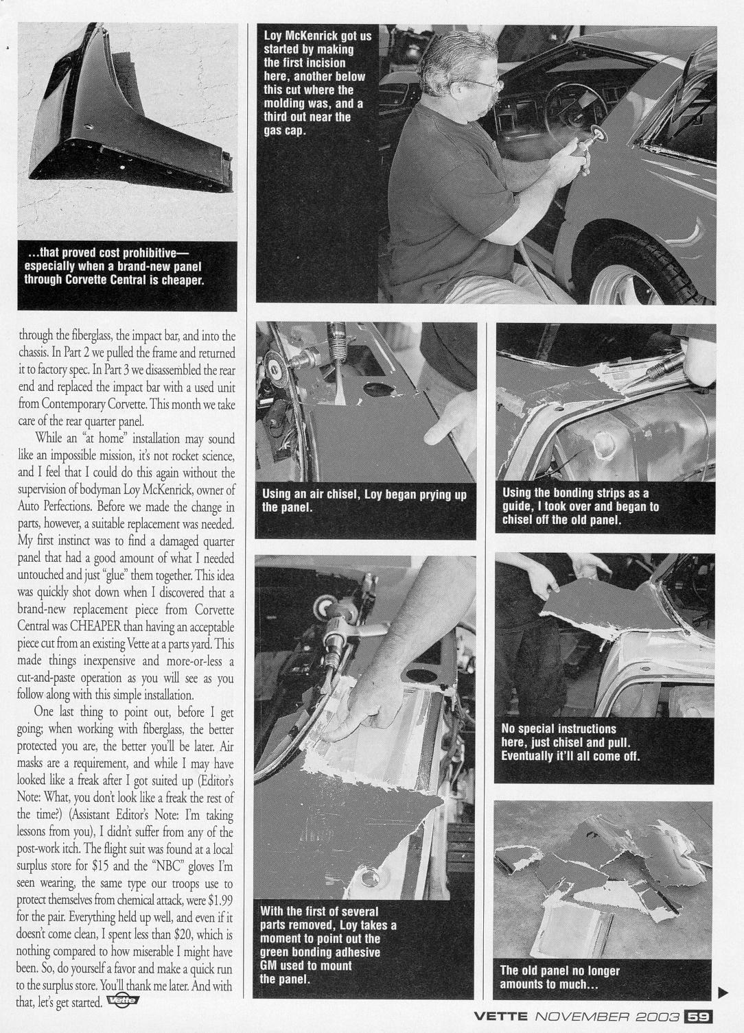

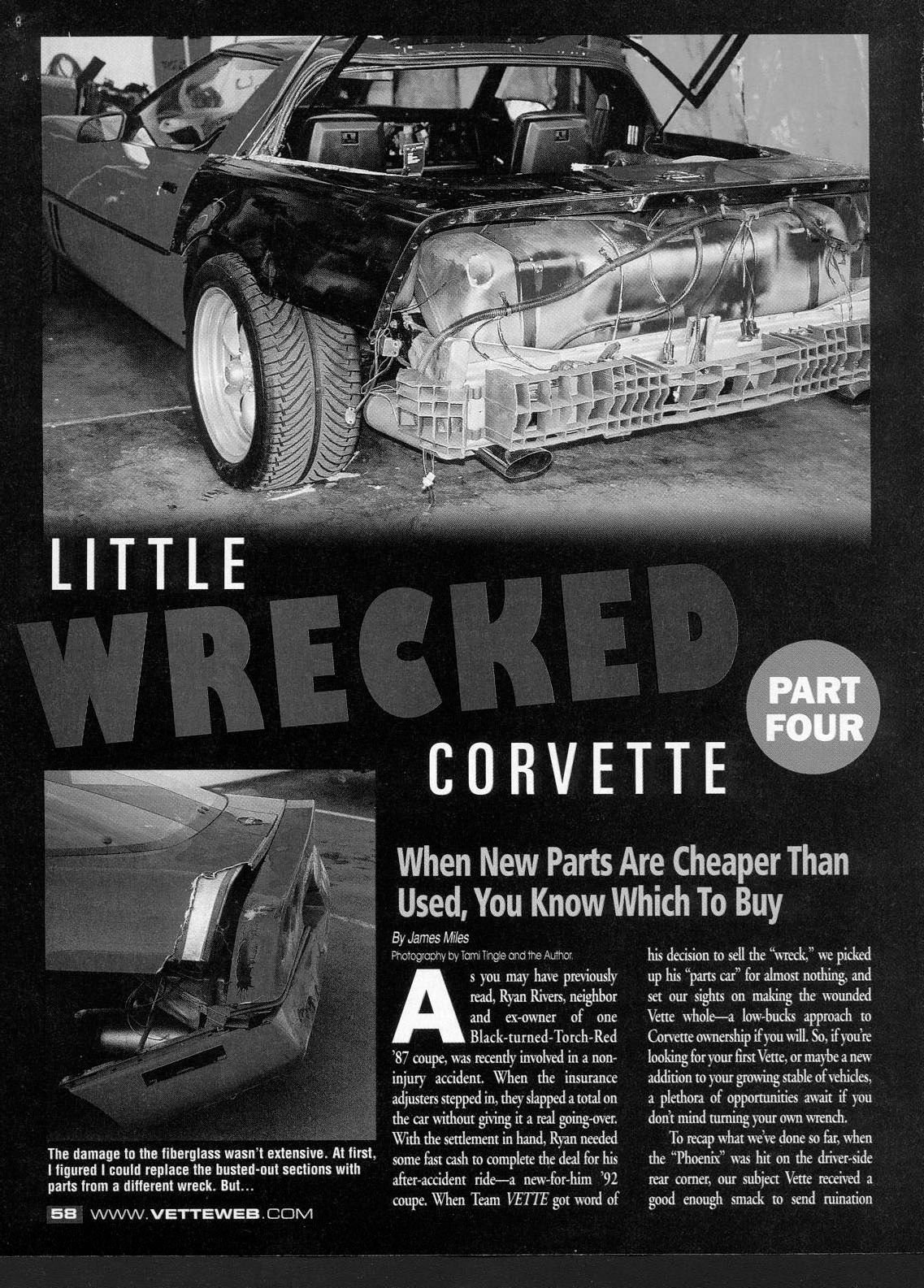

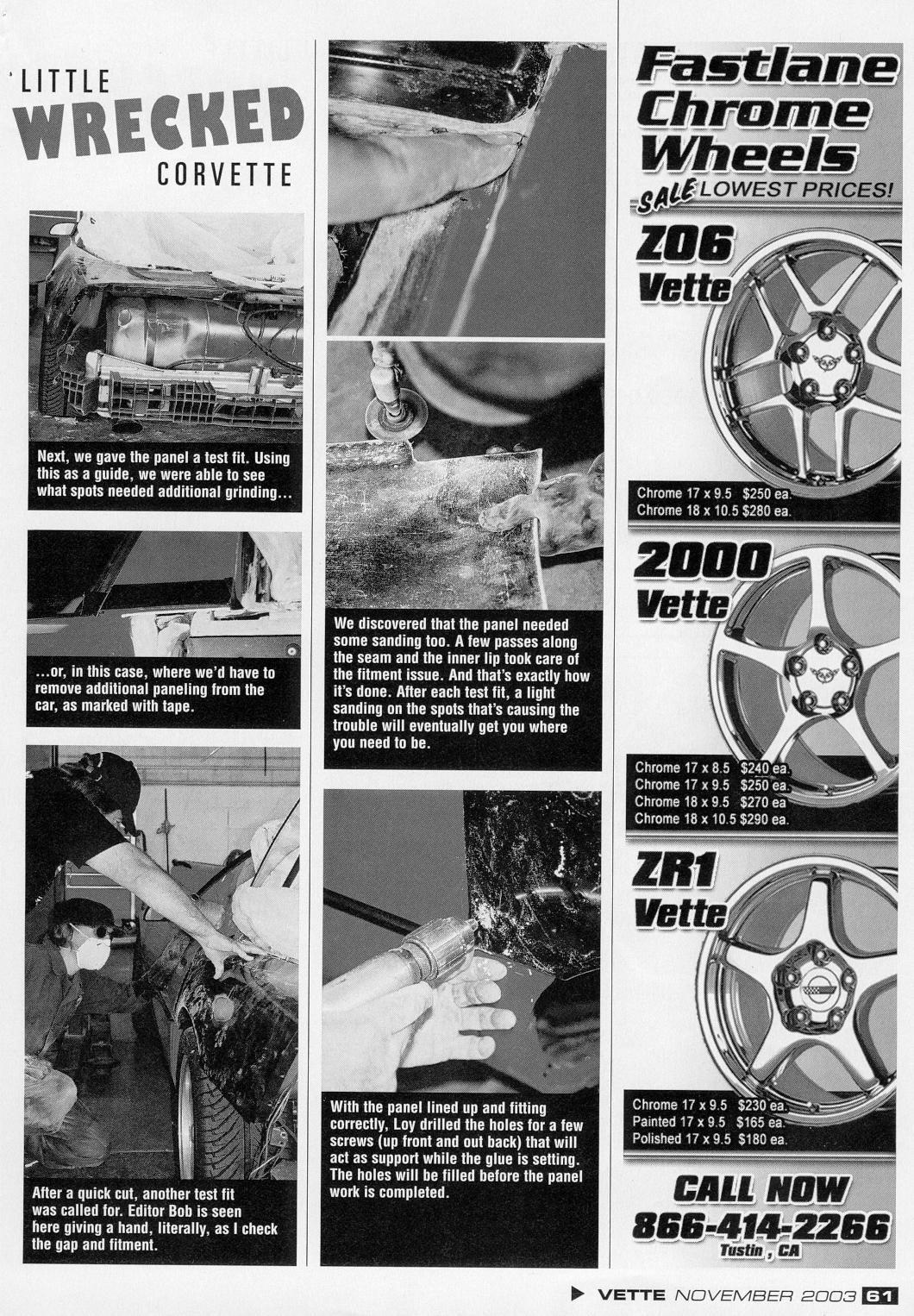

From an old post
Originally Posted by SuperL98
Scanned these years ago when I did mine ... not to bad a job
