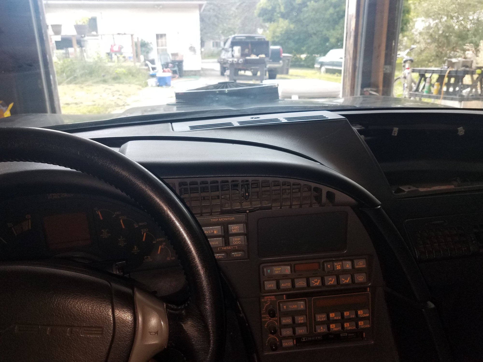

i dont want to garbage up the interior with after market gauges and big nasty tach's n stuff. i want to buy one of those a pillar pods for the afr gauge and that's it. it has a nice interior still, all black leather. the dash board has no cracks or nothing. it even has the original bose stereo system that i would like to restore. or at least replace the speakers since 1 is not working. it's a nice car really with only 120 k on the speedo. it wa s show car that caught on fire from leaky fuel injectors and the guy couldn't stand to see it in his garage cause it made him sick to look at, so he sold it to me for 500 bucks. and yes vin matched the title LOL first thing i checked

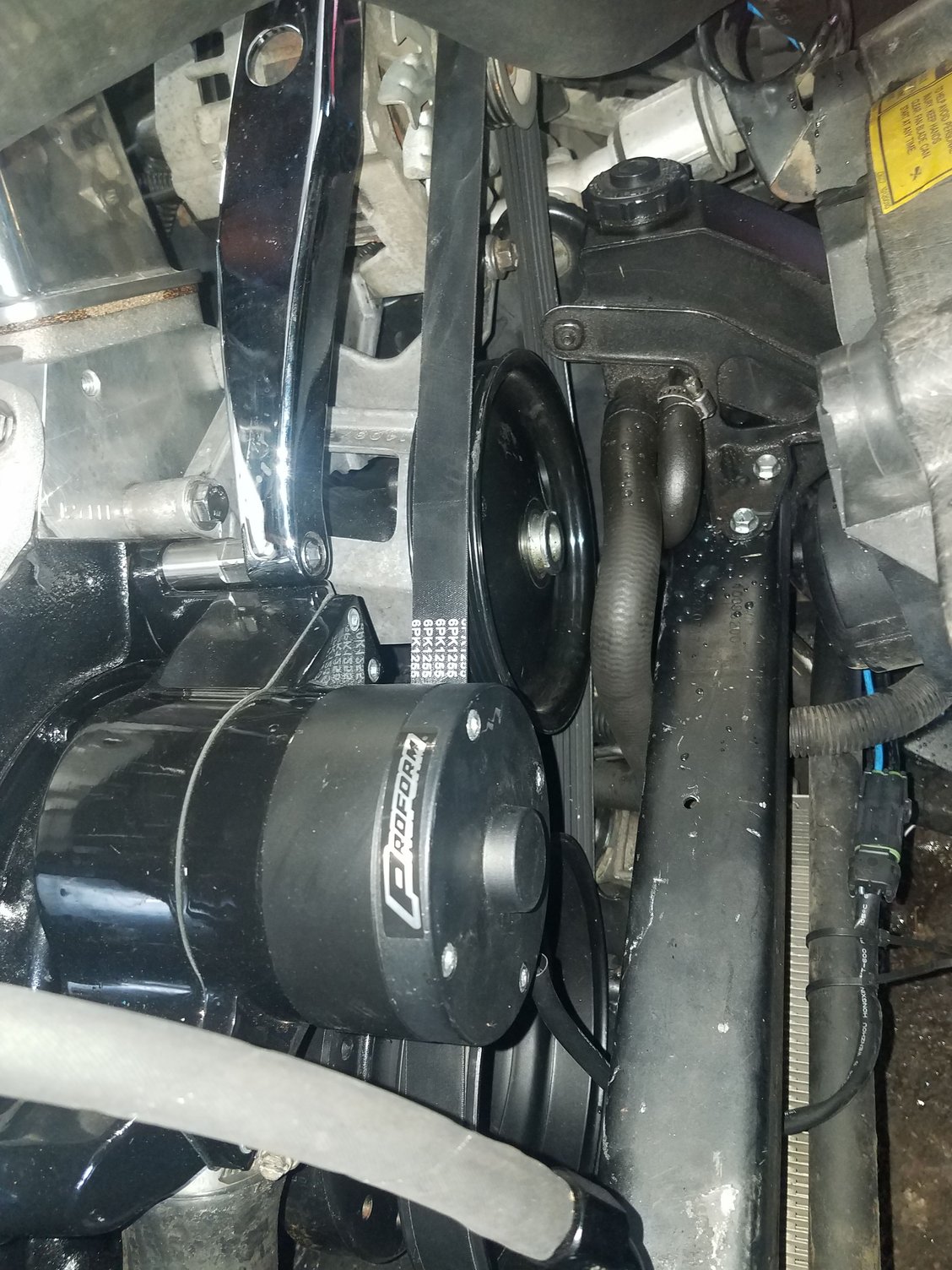

here is a picture of the pulley set up DWAvette. thats a C5 power steering pump and pulley. had to buy a new pulley to match the c5 pump because it is clockwise rotation instead of counter clockwise. counter clockwise has no grooves in the pulley. clockwise does. that belt fit in there just perfect. hitting on top and bottom just enough to make it work. i had to relocate the power steering reservoir a little for belt clearance but used the same hoses and everything. also had to modify the bracket to make it fit. took me about half a day and 4 trips to the hardware store.. but it held up to a 4500 free rev with a couple quick taps on the gas pedal and didn't throw the belt so i'm saying it turned out great. . just taking a little break from the 90 degree heat outside and thought i would show a pic. amazon should be here any time with my electric water pump controller and i can get more done. then change the water out to antifreeze after i am happy with everything. then finish it up. change the oil out to lucas break in 20-50 with a wix racing filter. adjust the roller rockers one more time then button it up. wish it wasn't so damn hot out there
someone laughed and said aint no way that belt will ride like that... well it does and it seems to be working great

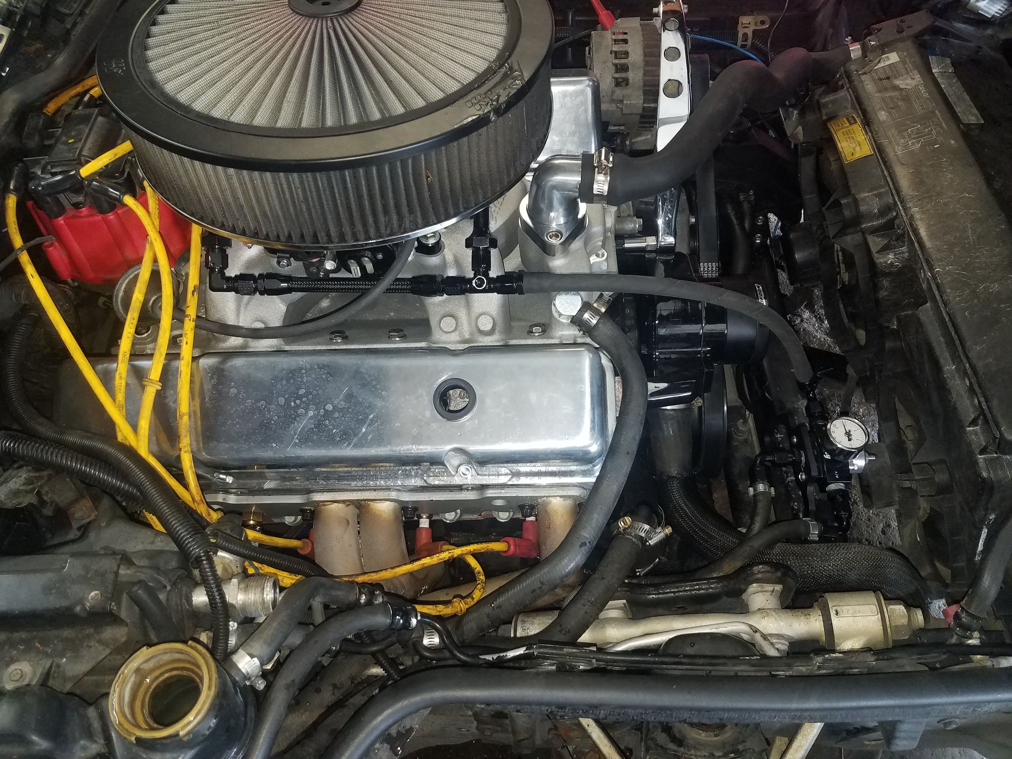

. this is not what it will look like at all . i am using them nasty old plug wires because i dont want to get oil all over my new moroso blue wires and and using the old distributor cap for now., i can perty it up later. i just want to drive this thing again.. upper radiator hose is just cut to fit with what i had. all that stuff will be changed to look good eventually. you dont see how dirty stuff looks until you see it in a pic like this. i power washed that thing about 4 times when the engine was out and it is still all grimy looking. control arms look dirty and everything to me. my VHT silver paint on the black primer hooker headers was a big fail also... nothing like the rusty header look on a new engine.. "sigh" guess i will send them to jet coat when i get around to buiuding the 400 small block . and no it was not running to lean. i just didnt do the VHT "break in" properly cause i was drinking and playing with rockers to loosen em up to get lifters to pump up.. nightmare pos car has F'd with me every step of the way. but i am getting it

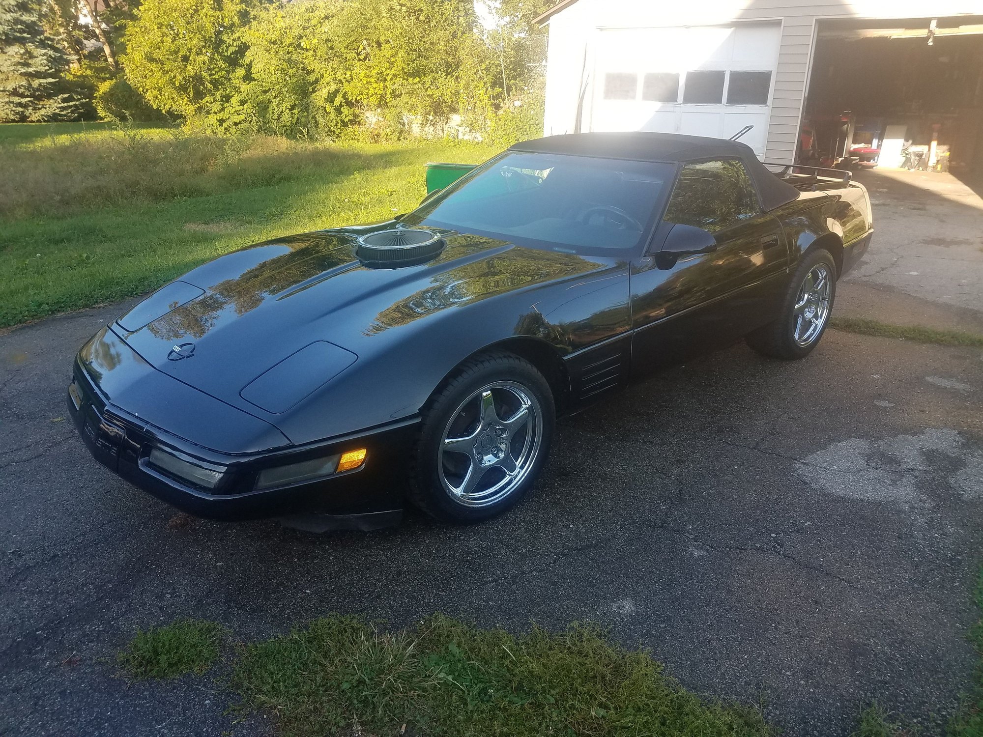

he don't fit quite right.... lol i kind of like it though, reminds me of my 76 trans am with a shaker scoop, loved that car. ole smokey

he dont fiot quite right.... lol i kind of like it though, reminds me of my 76 trans am with a shaker scoop, loved that car. ole smokey

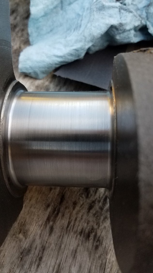

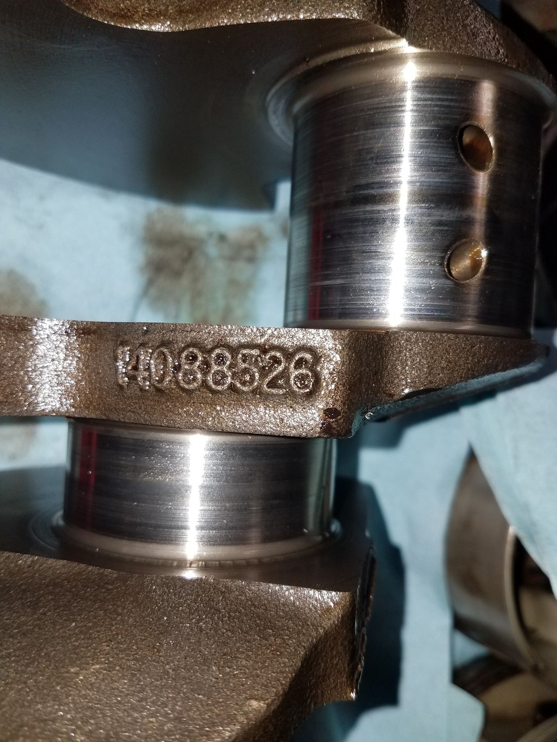

some pics on how i fixed the crank up
not totally wrecked but not great. needed some work for sure. i think it was mostly old bearing stuck to the crank instead of gouged into the crank. it was a decent running engine when i pulled it out.
this took about a whole weekend. wax on wax off, my arms were about to fall off when i was done.
finally called it good enough. i will know when i hold it down to 6500 rpm if it was good enough. i have 70 psi oil pressure cold idle though
