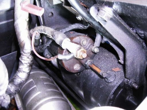

I found this on the innerweb i cannot see that well under the car - the battery is reading 12.8v i reconnected it and i tried to check the large wire which I am at this point - guessing is the feed line from the battery (please correct me if i am wrong) which is the large wire on top in this picture - if that is the case when i put the volt meter to it it reads almost nothing - like .5v - shouldn't it read the 12.8v from the battery or am i understanding this incorrectly?
if i am right then it would seem to be a bad cable from the battery to the starter? - maybe (i ask like this because nothing seems this easy)

I would do a double take at those battery connections. The post and battery connector should be wire brushed occasionally to help keep a good connection. Check your battery ground wire at BOTH ends. One of the big power connections is dirty and likely causing this problem.
The large wire on the starter was I believe the battery wire and yes, that should have had battery voltage. The other wire by itself is the "Start" to wake up the engine. If you don't have full battery there at the starter it is likely that you have a bad connection, or a bad wire. A bad ground will do the same thing here. Make sure all your connections are clean so they get accurate readings.

should have 12 volt on that big cable. if you hook a wire from big wire to little wire on the right the starter should turn over if there 12 volts at the big cable. if it doesn't turn over I would take out the starter. parts store will test it for ya

but if the big wire is not showing 12v - problem with the big wire . ..? - are there any other fuses/relays between the battery cable and the starter that I need to look at? anything to interrupt the juice to the starter - seems to be extra wires bundled in the plastic tube - -

I would get the Factory Service Manual and look up in there where the ground paths are. Otherwise just follow the black wire to where it attaches to the frame or engine.
That large wire feeding the Starter should have 12 volts all the time on it. If you don't see 12 volts it is either a bad connection of a wire that has too much internal resistance. On my C3 the battery positive wire goes from the battery behind the drivers seat all the way to the starter motor. I am not sure where the C4's run their cables but it should be in the FSM.
Can you get under the C4 and follow the battery wire? That would be helpful as I suspect you will see a defect in the wire someplace that is causing it not to let the power get to the end. On my VW it looked like a olive in the wire where the corrosion took place.
When I use a external starter switch it gets attached to the starter Large wire from battery and the second wire off by itself which energizes the solenoid to crank the engine. That is how it is supposed to work at least.
