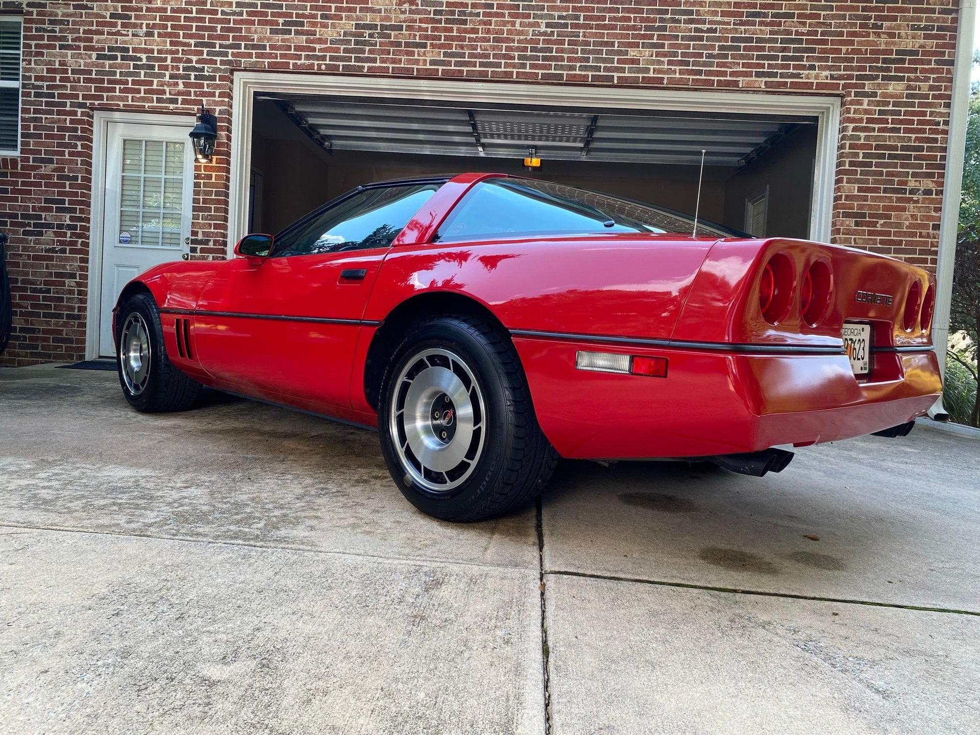

I just bought this car a week ago off the second owner. Has 1,450 miles on it. The original owner used it for 3 years then parked it for 30 years. The guy I bought it off owned it for 3 years. He gave me $6,500 worth of receipts that he spent to get it running when he bought it in 2018. This included cleaning out the gas tank, new fuel pump and sending unit, new fuel filter, and new injectors. He only drove it 100 miles and then parked it with a full tank of premium gas in early 2020 and did not start it again.
I then bought the car. The gas smelled normal, so I started it up and it ran fine. I drove it home 10 miles. It sputtered a bit when I tried to accelerate hard (thought it could be the old gas). As I stopped in my driveway, I heard a loud whining noise from the rear of the car in the area of the gas tank (it is not the power antenna which is disconnected). I drained 13 gallons of old gas out of the tank which was all I could get out with a siphon (gauge then read on reserve). I added 8 gallons of fresh premium gas. Took it for a drive and it still sputtered when I put my foot into it. Idles fine. The next day I took it for another drive and it sputtered again on hard acceleration and then died while I was coasting along. Restarted it and limped home. Can hear the loud noise from the gas tank area as I am pulling in my driveway and then the car dies again. I have not tried to restart it.
I suspect a bad fuel pump, even though it is only 3 years old and has done 100 miles. Any ideas of what my next steps should be before I spend money on another fuel pump? I was thinking about changing the filter first as it is cheaper.
