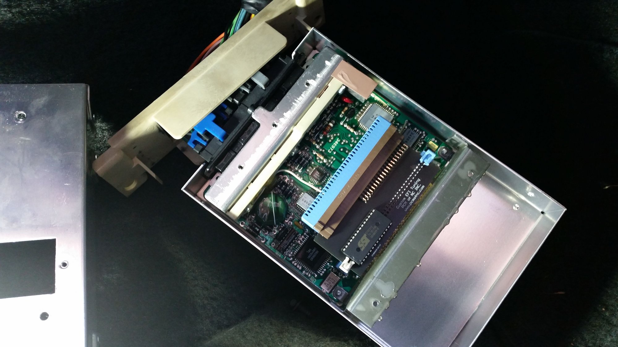

Just finished my install. Everything went as expected. The only thing that I did different is that I fully removed the cover from the ECM to get the new PROM assembly back in. It was super tight trying to get it through the access door without taking the cover off.
New fan settings are exactly where I wanted them. Going to grab lunch and then take it for a drive.

The way your MEMCAL is installed is like nothing I've seen before. Not in the past 30+ years, at least. Hmm.
This is my first time dealing with one of these. So, I honestly don't know how this design compares.

I'm surprised that for a 1227165 that it's NOT the suggested install procedure!
Do they actually 'imply' only removing the PROM cover?
For '90 and later it would be interesting to see an owner post thoughts of their install.
Did they offer only this or will they modify a supplied OEM/GM PROM?
No, I'm sorry if I was unclear in my first post. They do state in their install instructions that "Some early computers require removing the case cover". However, I had watched a couple of videos online where people were installing them just through the access cover. I'm not sure how they can do that. It is tight.
