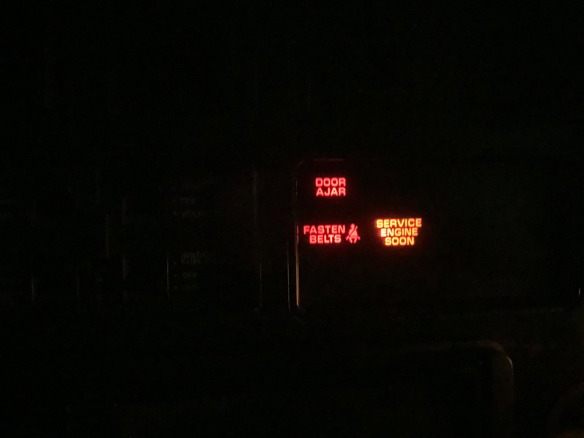

Just checked my 85. Door open yellow security light flashes. Key on seat belt, service engine, and door ajar (my door was still open) come on. Engine start all clear.
