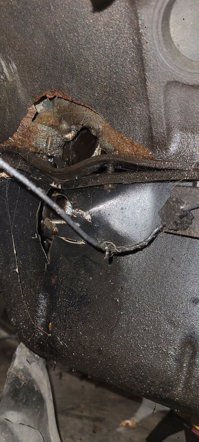

Here we go, new to this forum as of today. Just acquired my first Corvette recently. 87 convertible what's an automatic tranny . It was a barn find been sitting since probably 2013. Don't know much about its history or mileage excetera. Didn't have seats or carpet in it but pretty much everything else is there. The top is in really good shape. Under the hood everything looks to be stock except for an Accel super coil and a Cat- back MagnaFlow exhaust. I was told that they thought it ran when it was parked but nobody was really sure of anything. Got at home cleaned it up a little bit on the exterior just to see what I was working with, then open the hood to try to turn the motor over. Nothing doing. Locked up tight. So I went ahead and pulled the spark plugs, dumped in a little tranny fluid and diesel fuel, long story short three days later it's still not moving and I mean not at all. Now let me go back a little bit here. Stoked as I was to get this vehicle and couldn't wait to get it running just to be able to drive it, I made the decision that I would get it running get it cleaned up maybe even give it a quick paint job and give it to my dad. He's done a ton for me in and I'd like to do something for him. He used to race back in the day a little bit. Bought a brand new 68 Chevelle SS off the lot in 68, took it home added a few mods and some slicks and was racing it with less than 500 miles on it. I'd like to give him something to play around in during his retirement. Now back to the vehicle at hand.
I pulled the drain plug on the oil pan and the first second or so was water then came out what some might call oil. Lot of metallic particles. Then drain plug itself had a ton metal stuck to the magnet. I will try to post before and after pictures of the drain plug when I cleaned it off. Is trying to decide whether to pull the heads off with the motor in the car or take the whole thing out and check it over. I'm trying to do it as quickly as possible to get it to him but also on really strict budget. So I had all kinds of scenarios going through my head. I decided to pull the motor, pull it apart see what I had. Put it up on jack stands, slid under the car to take a look see what I was up against as far as getting out the transmission to motor bolts and also to try to figure out how I was going to get the motor separated from the transmission when it's locked up and won't turn. That's when I discovered something that made my decision on what I was doing with the motor, a lot clearer. Needless to say this motor well, at least the bottom half is shot. My question is what are the chances that the upper half is still good? Another question is as I said before how do I pull the motor without the transmission if it's locked up? Lastly yeah, I'd like to keep the tuned port injection, as well as be able to keep the stock gauges intact. That being said I would like to be able to get 375 horsepower minimum out of the motor when I put it back together. I have no emissions restrictions, and I have done some motor work before but I don't know a ton about the in depth "numbers" portion...enough to be dangerous I guess. I'm wondering what my best options would be to get it back on the road fairly quickly and as I said before on a pretty strict budget. Also I want to get rid of the air pump completely and try to find this set of used headers. I haven't checked into it for sure but I had a DiabloSport Trinity some years ago that I really liked on my 06 GTO. I was thinking of looking into something and those lines as far as being able to tune it. Am I we are faced with that? And lastly with the motor being in the condition that it is and how it obviously had to meet its demise, is the transmission still going to be good? Thank you in advance for your help.
That is the drivers side of the engine where it meets the oil pan

The heads might still be OK, but you need at least a short block. You might be able to pull the motor with the torque converter still on the flywheel, or drop the trans out first, then pull the motor

I wasn't sure if there was enough room to slide the motor forward enough to get torque converter off the transmission

Right, idk either, there might be enough room if you take off the accessory drive and rad, but idk from personal experience. If not, you can drop the trans out first. This will be a bit more effort either way. Hopefully someone that's experienced this before can chime in, it's not unheard of.
