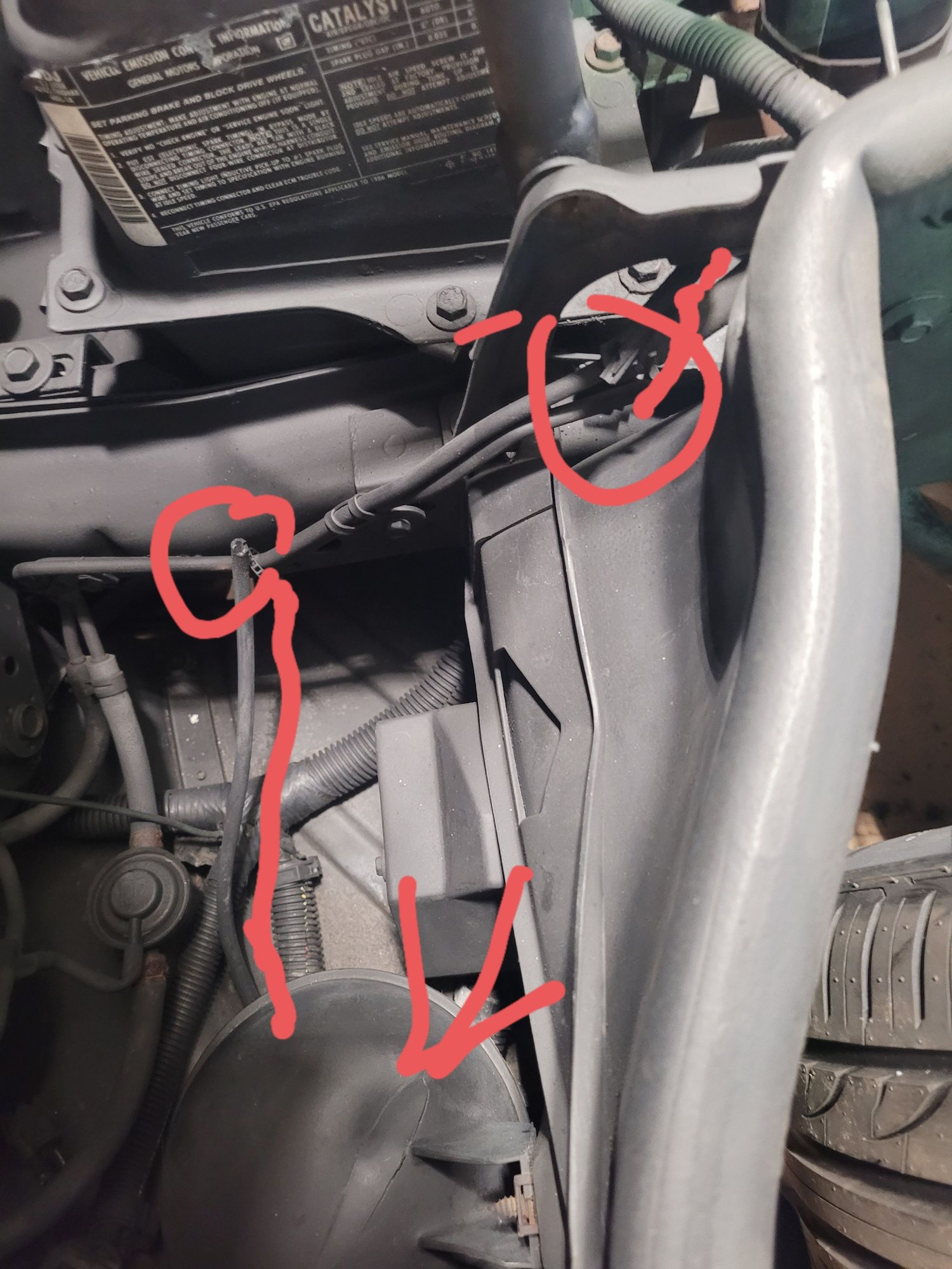

I bought this vette has some rotten lines not connected need some help with routing
The long vacuum hose not connected ehter side and cruise lines 2 short lines 1 bigger and 1 smaller vacuum lines not connected rotted off
Vacuum ball line not connected on left then on right is other end of long hose

Unless someone removed it, you should have a vacuum line diagram decal on the top LH side of the radiator shroud that looks like the one below.

The fatter hose goes to the brake/clutch pedal area, the long thin line goes to the Vacuum tank in wheel well there should be a tee along the line to bring in a Vacuum supply.
As for repair unless you feel the need to replace all lines simply cut away Rotted and use regular off the shelf unions and hose. It's a not uncommon repair the hoses near battery take a beating from acid gas's. On my car I put the union in a ez to reach spot because I know it will happen again.
Note the vacuum lines may vary due to various options, make sure to check for YOUR label first.
