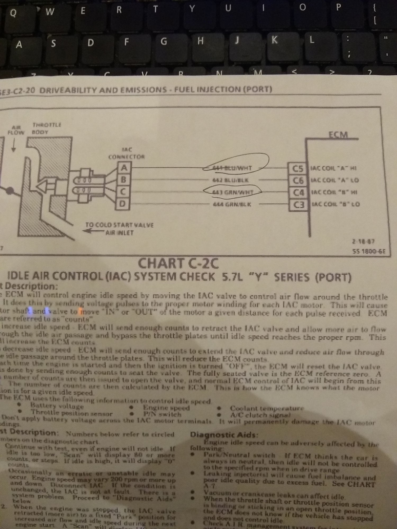

Just an update: I used a system check chart for the IAC today. As it turns out
two of the circuits have no power. Going to or coming from The ECM In this
case it CKT,s 441/643 I traced back to the firewall and no power......ECM?
Anyone who can help me with this would be appreciated!
Thanks to all

I did check the pintle and its good. the idle somewhat goes to normal when i disconnect the plug for timing.
I did check the timing and it was set at 8 degrees, I put it back to 6. it seems no matter how many times I set
the TPS @.54 it always changes. Reference signal for the TPS eventually goes to .5 volts. I pulled the ECU and sending it to
an outfit called G7. for $225 they will test and repair if needed, if nothing is wrong they send it back with a full refund.
I found a Reman ECU in the car, so???
and on it goes! I WILL solve this
Thanks
Bobb

As it turns out it seems the ECU was bad. The folks at G7 told me the ECU had some hardware problems. As I stated earlier I was getting differing values on the TPS. I would set it at the prescribed .054 and when checked again it wold show .029,.071 etc. Next I checked the signal wire. it is rated at .5 volts, it would change from .010 to .6, sometimes .5volts. Anyway, put in the rebuilt ECU........done and perfect. Thanks to all for the help!
Bobb
