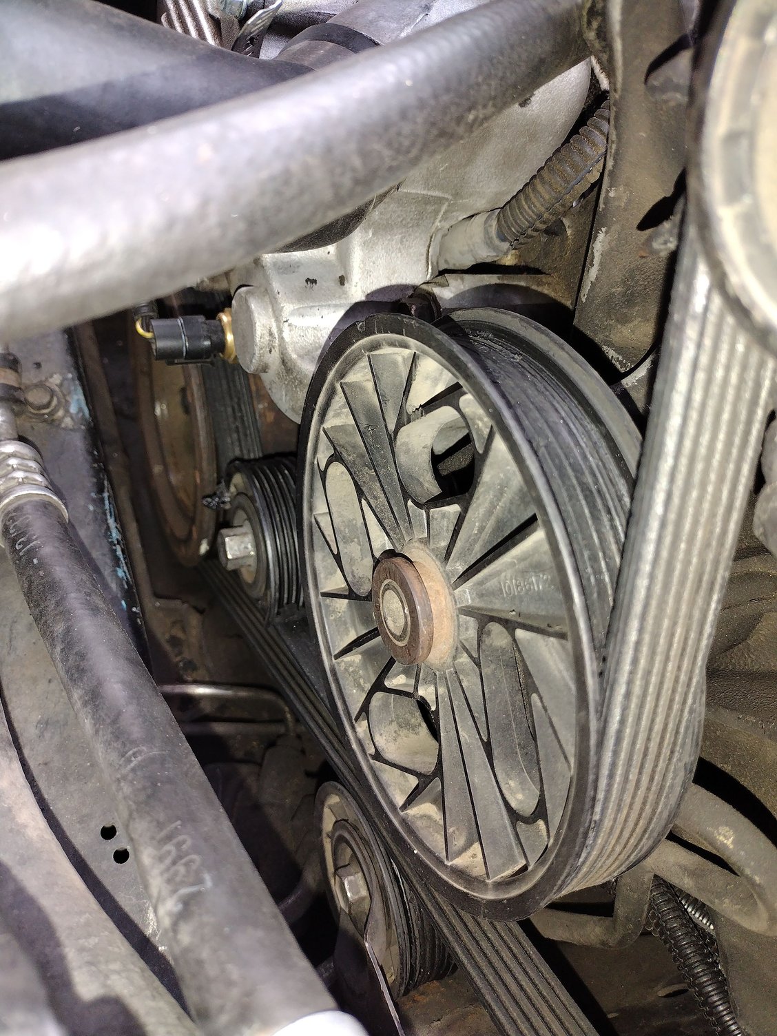

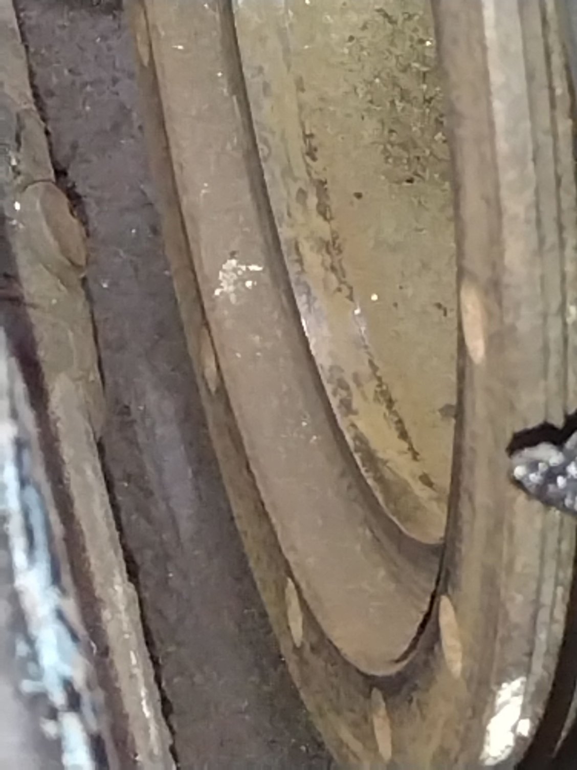

I started my vette today and heard a loud shearing sound from under the hood like the serpentine belt shredded. Shut her off and popped the hood. Sure enough the serpentine belt was shredded. The tensioner pulley looks like it melted and a big part broke off. In ordering a new one I came across symptoms of a going bad belt tensioner are erratic timing, noise etc. I didn't really hear anything until the failure, but definitely have erratic timing. I also looked at the harmonic dampener and it looks pretty bad. There are gaps in the rubber ring. Another thing that can cause erratic timing. So for the time being I am going to replace the belt, tensioner, idler pullies and the balancer and hope that solves the "turbo" issue.

The damper won't change the timing.

IDK, but the outer ring on the damper could slip/rotate 180* and the engine would still run the same. Damper has nothing to do with cam or ignition timing; the engine has "no idea" nor does it car where the outer ring of the damper is.

I haven't really stayed on the throttle or really pushed her to her limits yet. With 184k on the clock and new to me, I am still going through the easing into her process. Plus the tires are risky. I just got my Mickey Thompson 275/40 17s and was taking her to my shop to install them when the tensioner pulley gave out. Figures. As far as what I have experienced with her, when I accelerate onto the freeway she does the boost thing right at 3500 rpm. I usually shift no later than 4500, max 5000 rpm. The power feels constant at that level. I'm sure I could push her harder, but haven't due to tires and just not being confident in her yet.
At this point, I'll do the idler, tensioner and dampener then see how she feels. I do plan on doing the timing chain and oil pan gaskets, but would like to wait until it warms up. The weather has dropped into the upper 60s. At night it gets into the low 50s.
