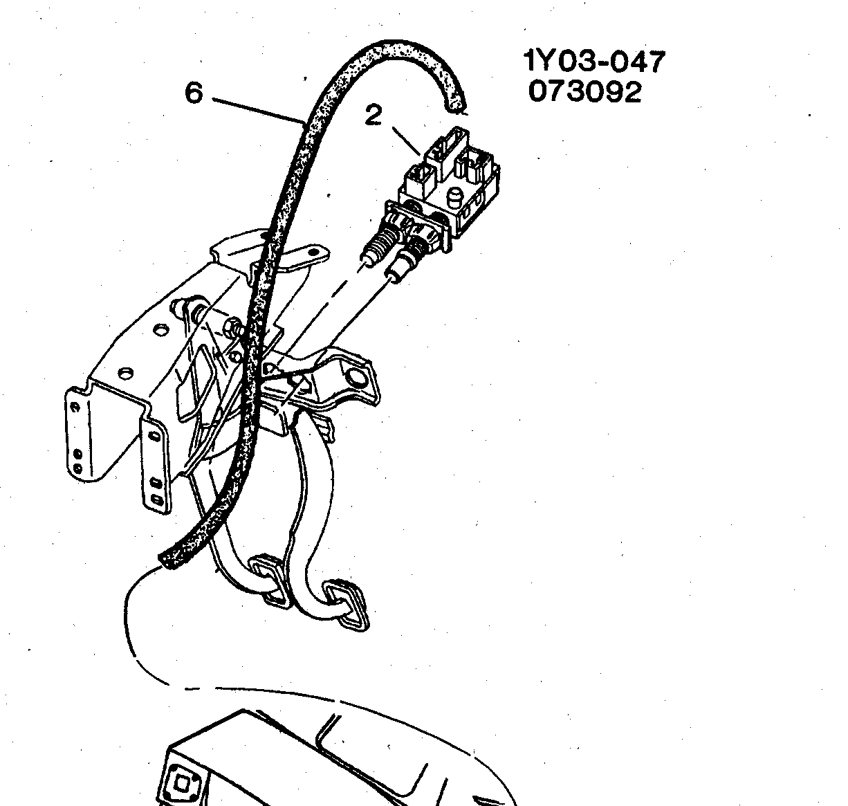

That SLS that's offered by 'CORVETTE PARTS/DAVIES' is I believe just an F-BODY & other GM SLS. Try changing this GM # 25551819 at your local NAPA or favorite auto parts store!
*** A GM 10170430 ACD D1541D on a 'local' GM dealers shelf or ACD jobber might be less expensive. Changes to the same NAPA or other AP store. Seems it's a newer GM # for the other I mentioned.
The '93 + from GM was a combination that you'll see here but that F-body I believe should match your needs. From NAPA or your favorite AP Store I'd guess maybe $15 max and no shipping = maybe less!
https://www.corvetteforum.com/forums...connector.html
If you're an eBay kinda guy check the connector indexing of this one and spend 10$.
https://www.ebay.com/itm/40325874345...UAAOSw73xheLG5
If you have the FSM connectors are 8A-202-25
