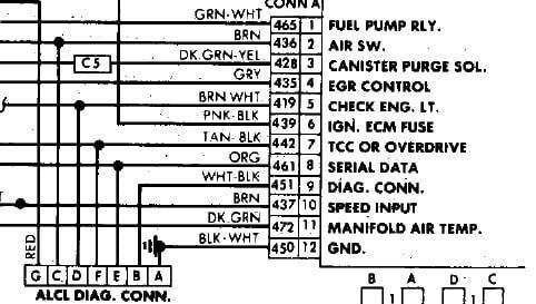

This is what Iam looking for but I believe its for the wrong year I am working on. Can seem to find it in my FSM.
