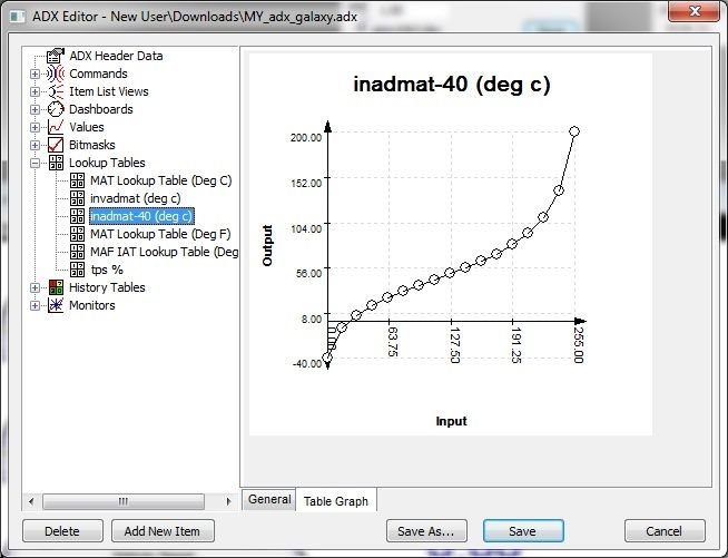

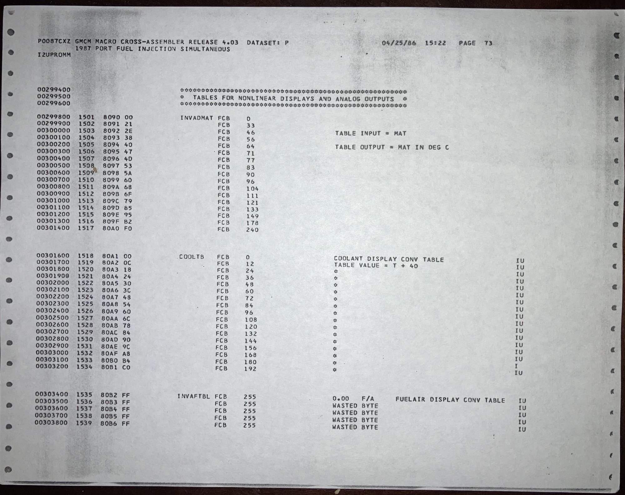

In 86 and 87-88 L98 maf cars, the MAT sensor is only used functionally as an EGR enabling condition (86: MAT > 30 is needed to enable EGR. This was increased to MAT > 46 for 87-88). The MAT signal is also used for diagnostic purposes in order to set Code 23 (MAT low < 4) and Code 25 (MAT high > 243) which also impacts EGR. If a MAT failure is detected, the default value of 29 will be used, which is just below the EGR enable threshold. The MAT sensor has no influence on the fueling of 1986 and 1987-1988 L98 maf cars. 1989 is a bit different in this regard, but I won't get into all of the details here.
Installing the MAT sensor where it is subject to ambient air temperature will effectively disable the EGR at lower temperatures and accomplish nothing else.
Note: the MAT a/d value is inverted prior to being stored and the scaling is not linear, so a lookup table is required to scale the raw inverse a/d value to an actual temperature. If I'm reading the lookup table properly, a raw value of 30 is about equal to 45 °C or about 113 °F.
Update: On second thought, I think the table that I have shown includes a 40 °C offset, even though it is not explicitly commented that way. With the 40 °C offset subtracted from the output value, a raw value of 30 would be about equal to 5 °C or about 41 °F. For 87-88 cars, a raw value of 46 would be about 15 °C or about 59 °F
Would be nice to see some raw MAT a/d data along with respective data scaled in °C to compare against coolant temperature in °C on a cold, not running engine as a sanity check for the MAT temperature conversion.
2nd Note: I'm not using the factory MAT in my own car, so I cannot easily test and confirm the MAT inverse a/d value vs actual temperature to confirm the accuracy of the lookup table. Instead of the factory MAT, I use the IAT sensor that is integrated with my analog slot-style MAF sensor. Since the IAT has different resistance compared to the MAT, it requires its own unique look up table to make sense of the inverse a/d values along with modified programming/tuning. The IAT responds to temperature changes much faster than the MAT.
Later speed density L98s (90-91) do make some use of the MAT sensor, since a MAP sensor alone is not sufficient to determine air density.
MAT table:
Result looks like this:
Think this is more like it:
After reviewing some old cold start data that I happened to have available, the inadmat-40 table shows good correlation with respect to the coolant temperature from a cold start.
https://datazap.me/u/tequilaboy/cold...&mark=19-37-49
Note: the mat signal scaling in this log (°F) was also a bit off when it was initially recorded and exported to csv, but after correction the resulting raw signal is bouncing between 60 and 61 counts. With the correct conversion to °F with the -40 ° offset applied, 60 counts is 72.5 °F and 61 counts is 73.4 °F, both very close to the 72.05 °F coolant temperature. Close enough for me.
Here is my mat scaling expressed as a 17 row table:
