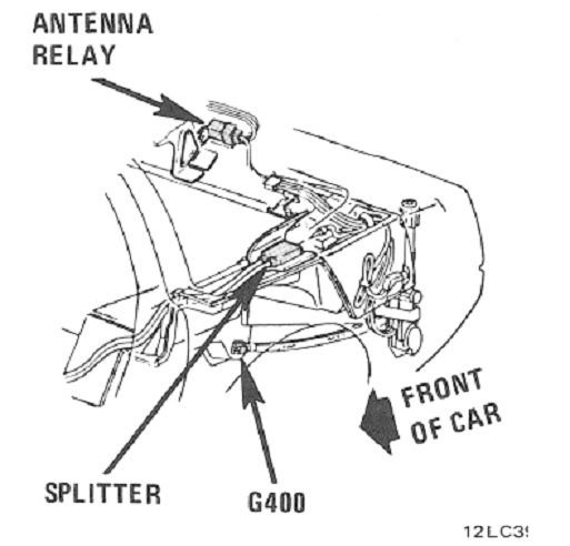

I have an 1985 C4. I have a continuous running antenna motor when the battery is attached. Is there a way to disable this motor without a dismantle of the rear left quarter? Is there a fuse or relay or connector within reasonable reach? If so, where? If not, what is the best way of stopping it from running>

Driver side (in usa) is always the left. Passenger is right side. Left and right are from your perspective sitting in the car.
The rear deck lid trim piece you need to take off. Its the big piece across the rear cargo area (with the spring loaded targa piece) under that is a relay for the antenna and the hatch pop. Should be obvious once you see it.

I errored in post #2. The support is at the rear body panel, relay is pictured. I did PM you regarding a FSM for your '85.

Yeah, all of that makes sense. I can do that. Your response is very helpful.
