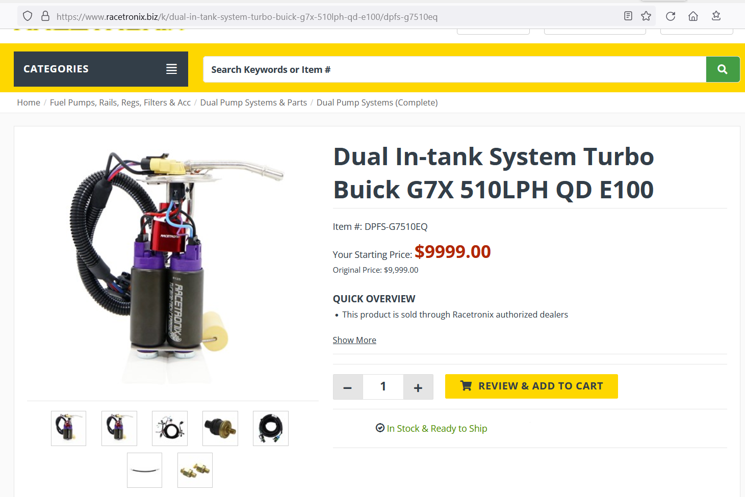

Old May 18, 2022 | 04:13 PM
C4ProjectCar's Avatar
C4ProjectCar
Joined: Jul 2014
Posts: 1,426
Likes: 46
From: Lynchburg, VA
Originally Posted by Mike in Boston
Is this price in pesos???
Cracked me up
I've wondered what was with the $9999 prices on their site - not terribly obvious that there's an MSRP hidden on the page. It looks like their Buick kits list an MSRP of $700-$800, so DIY is the route for me for a few hundred less.
