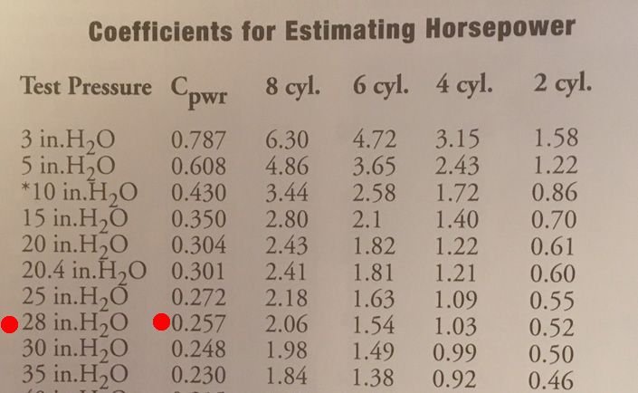

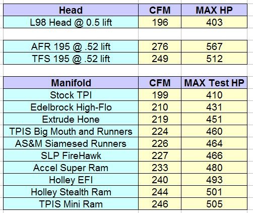

Looking at this a different way ... Math
Based on flow bench and dyno testing, SuperFlow developed a power coefficient based on airflow.
For a V-8 ( Test Cfm of any head or manifold ) X ( 2.06 ) = (Max HP potential)
The stock L-98 head flows 196 Cfm @ 0.5 inch lift, so the most it could support would be about 403 horse power, and that's before adding in the flow loss from a manifold and throttle.
The famous Richard Holdener "Ten Times the TPI test" we all know and love is very interesting to look at this way.
The 383 with big heads was designed to tax all the manifolds to the limit.
The article says it's used TFS 195 heads, but he says AFR 195 heads in the YouTube video.
Either way the heads support more horsepower than all the combinations make, so you could say the intake manifolds are the limiting factors.
With all that in mind, here are the calculated flow rates from max HP, for the different manifolds.
Doesn't matter that the test is a 383, could be any engine, the chart shows roughly the maximum Cfm & horse power the different manifolds can support.
Pick your horsepower, than pick a manifold accordingly.
Obviously the engine, cam and head combination you pick need to flow more than the manifold.

interesting…
but why the FIRST not included? I wonder where would it go in the list ..

I seem to recall someone asking in the comments and if I remember right it may not have existed or was new when the test was originally done as it's pretty old data now. But stock it's been reported they flow in the 230 range so... about 480hp as the results there are bang on to the cfm correlation.
Old Feb 8, 2022 | 06:50 AM
SuperL98's Avatar
SuperL98
Joined: Jun 2001
Posts: 1,704
Likes: 459
From: Mass Mass
I did look around for comparable dyno tests using the First Intake, but information is scarce.
Lot of talk ... but not much data.
Most discussions refer to Precision Race Engines building crate engines with the First Intake.
Claimed numbers are 425 hp for either a 350 or 383 and one reference to a 434 that makes 450 hp ... which is the highest claim I can find for the First.
There is one YouTube video posted by Precision of a 383 making 404 hp @ 4500 rpm.
Keep in mind the "STOCK" First runners are only 1.75 inches in diameter.
Also, before the Mini Ram faithful chime in ...
If the TFS head was actually the one used, the Mini Ram and Stealth Ram are close enough to the head flow number it's possible they may have made more power with a bigger head.
