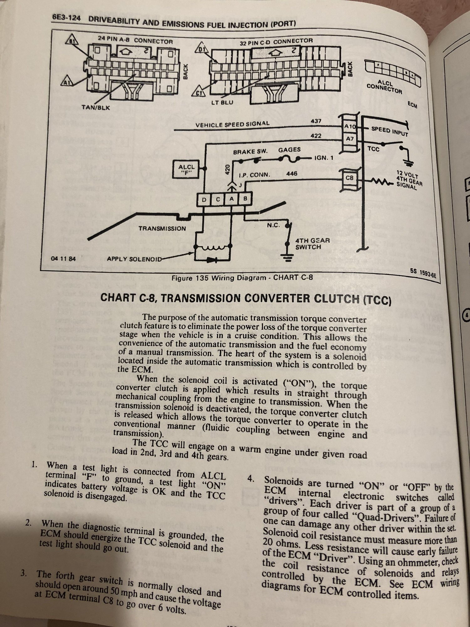

The shop replaced the solenoid but the lockup is still not working. The shop connected another external wire from the transmission towards the car battery. If you apply a ground to the wire, it is supposed to engage the solenoid (when the engine is ON or at least switch is ON).
The wire did the trick and engaged the solenoid when it touched the ground. So why does it still not work with the ECM? The shop called me. I brought the car’s FSM. I read that ALDL port “F” should act the same way as the workaround wire.
We took a drive, we connected a wire to ALDL “F” and its other side to a ground when we wanted to engage the TCC. works… but why does the ECM not engage the TCC?
I check the continuity between “F” and wire A7 that connects to the ECM (A7 is TCC control from the ECM. it sends a ground when the TCC lock is met). There is a continuity so why is it still not working. I opened the FSM again and I read that a solenoid resistance should not be below 20 ohms; it can hurt the ECM.
Lucky me I have another ECM unit at home.
I replaced the unit and went for a test drive. The TCC lockup starts to work.
My theory: The old/faulty solenoid has destroyed the ECM’s drivers that control the TCC lock.
