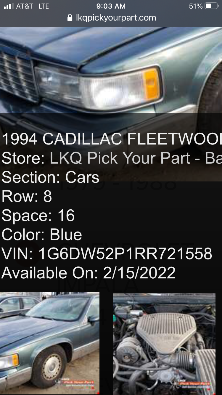

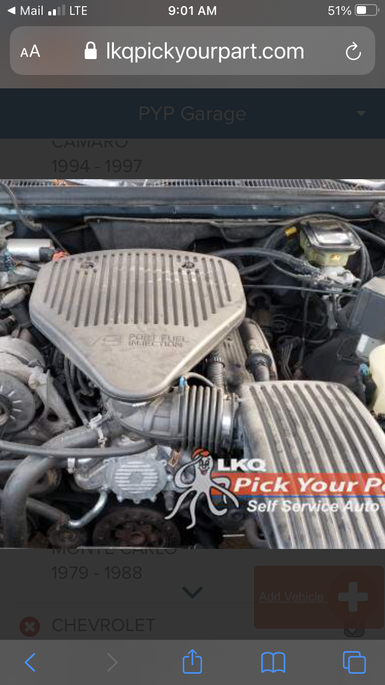

Anyway here’s a 94 Fleetwood LT1 that just showed up in a local Baltimore junkyard. In addition to getting vented opti and other related components, these cars are also good donors for the 8051 OBD1 LT1 PCM’s. They work on all LT1 cars including those who wish to step down from OBD2. I’d run up and snag this one but I already have a couple spares here in my garage. Notice in the pic below of this 94 Fleetwood engine. See the opti vacuum line vent connected to the intake bellows?

They’re also good donors for the various sensors, ICM and related components. Good opportunity to get cheap spares here. Many you can still find the functional OEM stuff still there

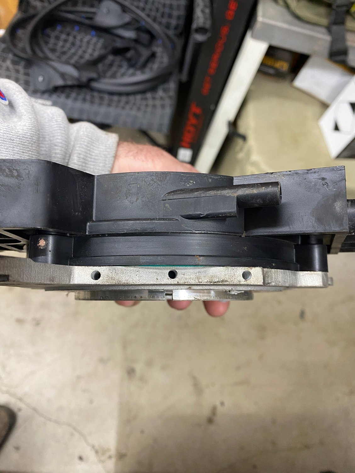

Default Is this right

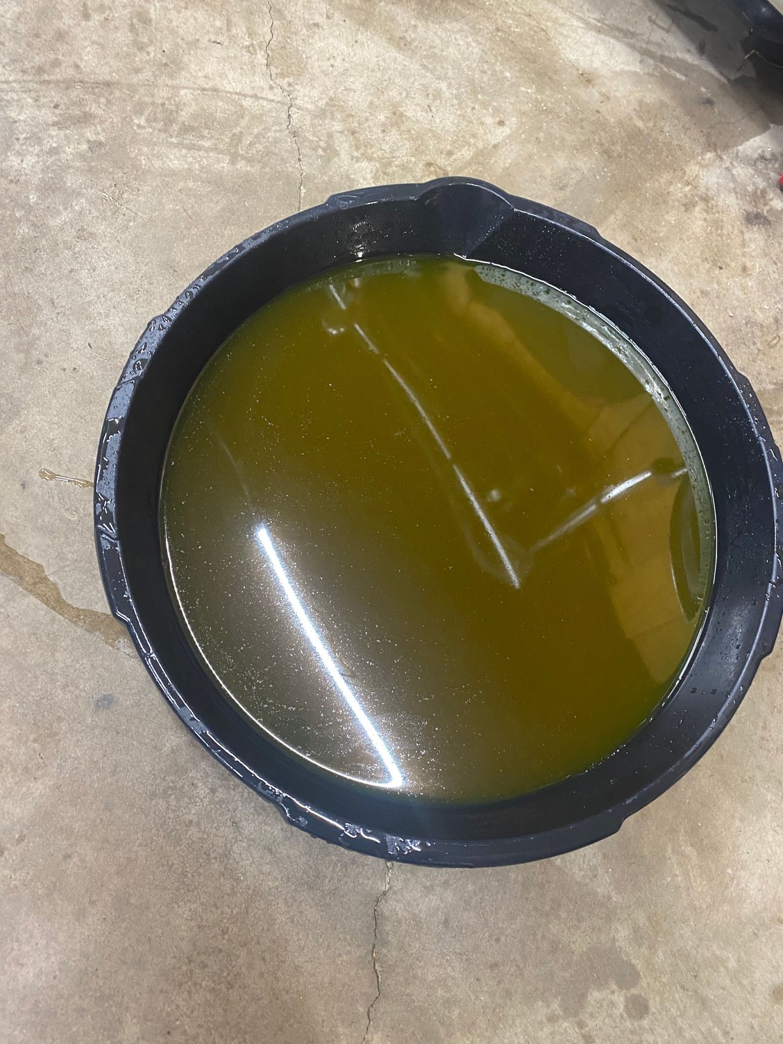

Day one breakdown…..came apart nicely. PO installed a vented opti but did not install the hose.🤦🏻‍♂️ So I’m guessing my opti is shot because of this. Nonetheless, I have the Petris in hand and should have it back on tomorrow. My question is, I drained the coolant and the color was not orange, nor was it green but more like Carmel color…..
should I do a flush and change the thermostat? I’ve read the orange and green don’t mix and can cause issues.
Guesses on brand/make???

A true vented opti has two vacuum line connections. One in the cap (plastic) and one in the distributor body (metal). Does your old one have both? It’s possible to put a vented style cap on a non vented distributor body.
What does the optical sensor look like? Can you post a picture of it?
On your coolant question, they now make green colored coolant which is designed to mix with all other types of coolant, regardless of color. Perhaps the PO did that. One thing for sure is if non compatible green coolant had been mixed with Dexcool, the result would be nasty brown sludge wreaking havoc on the cooling system.

Flush the entire coolant remaining while you’re there. A no brainer IMO

Looks like the PO skipped the step associated with completing the vented process! Lol 3 small holes on bottom of the aluminum part and the vent tube on the cap screams “vented” but nothing connected up soooooo seems more like it screams “water/contaminants entry point”
going with the green…..agreed?
Yes that’s what I put in my 93, I think Dexcool came in 95 or 96
That is a vented style cap on a non vented style distributor body. The non vented units had those three “drain holes”
