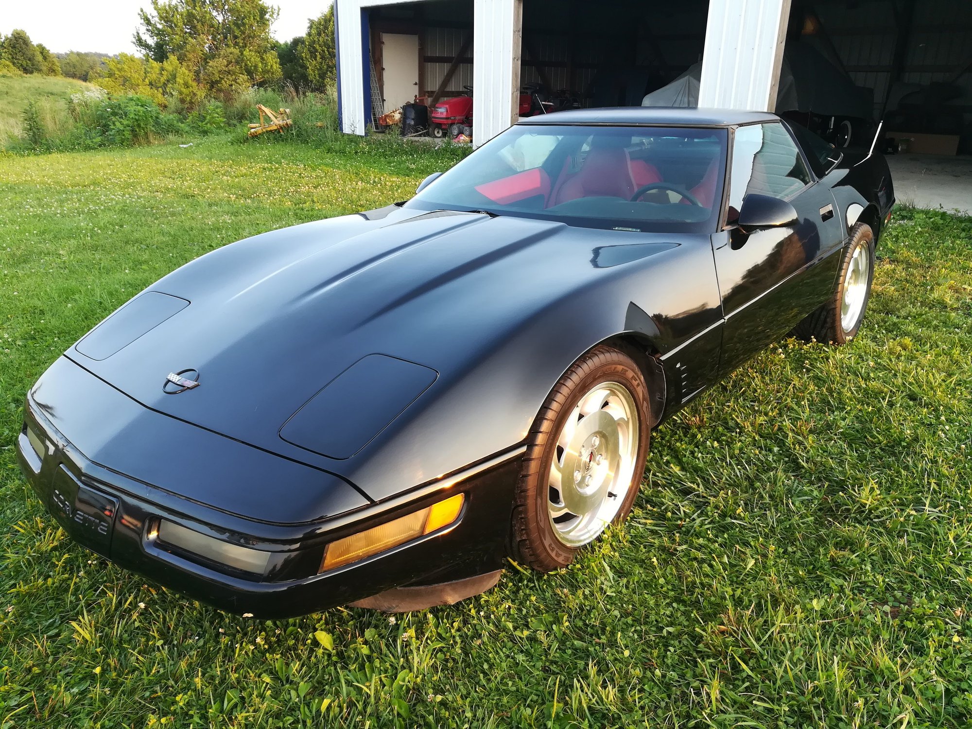

Thanks for the feedback. I guess I won't know until I try. My car is a 1996 base car with the weakest factory springs: 306 lbs/148lbs. They look like a crutch for my weak springs. Is your red car a 96?

​​​​​​This way I know what to expect. I am bringing my car back from sitting for 16 years. Fuel tank, injectors, filters new brake lines, tires, etc. So, I will put Ridetech HQs on my wish list!

I have found some springs, FHA and NYU and a front 30mm front sway bar thanks to FB marketplace and this forum's WTB section. I am trying to closely duplicate a ZO7 setup from 1992-95 on my 1996. I will see how these springs and my custom shocks play together. Thanks for your help!
