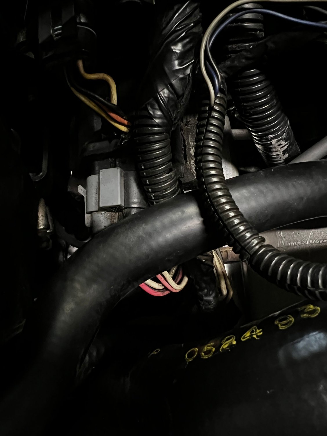

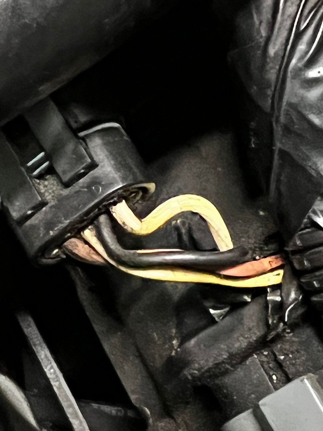

I have fuel pressure regulator that I am ready to install, regardless of this has any thing to do with the issue since it's probably over due. I changed out the fuel pump relay under the passenger side dash in case it was not operating properly, even though the pump does come on for 2 seconds, I though maybe it was running after that? hence the car dying? I also have a new fuel filter to put in, thinking possibly its getting to 40 pressure, but not getting enough flow still? I have done some research on the ICM and in watching some videos and looking at wiring diagrams and wondering if that or the coil could be the issue...but here is where I am stumped - the four wires I have going in to my ICM from left to right are what i believe to be pink/orange, then yellow then black the white. I think these are the colors, they are so faded it's hard to tell...but then I see wiring diagrams menioning purple, then I see vides showing green? I want to test these with a light tester but don't know which are which.

Ready to get the weekend started and hoping to test out the wiring, so I could use some help determining why my wires don't match other posts and info I have found. any thoughts so I can test the ICM and coil?

I appreciate the thoughts...I did the last bit of checking I could think of, pulse at injectors power to the icm and coil. while testing the icm I found that it is not switching on ...it has power, but when you start the car the white wire is not blinking on the tester. based on what I have found in posts and online, that also points to the PCM/ECM.
