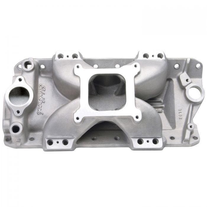

An Accel Super Ram is an intake manifold, and includes the plenum, runners, and base. The Victor E you say you have is also an intake manifold that includes the plenum, runners, and base (all cast as one piece). If "you know what it is" then you know that this:
Doesn't "work with" this:
They are two items that do the same thing and don't work together. You use one or the other, not both. You don't "run a super ram on the edelbrock carb single plane intake" - that's not how any of this works. Is this a real question or are we being trolled?
If it's a real question, then you should use the Super Ram with those heads, because those heads don't flow much and won't support the Victor's strength (lots of flow, high RPM, high power). Then use a small cam kit such as the Comp Cams K54-408-11 kit, and you might get 300rwhp out of it. It would be a real upgrade over the stock L98 at that point. You might need bigger injectors - I'm not sure - and you'll have to figure out tuning because this is enough change to require that.

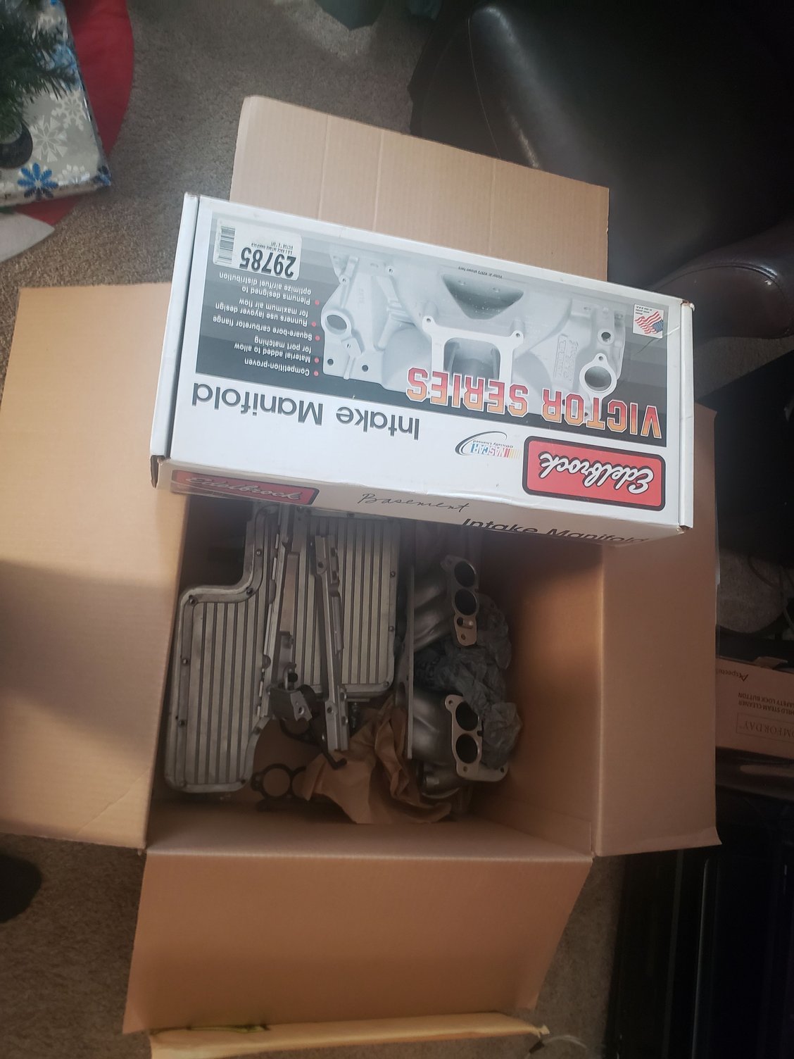

Maybe you have a complete super ram AND the 29785 intake. That intake number shows up as a super victor with a 4500-8500+ power range. To fit the super ram to the intake someone would have to block off the runner ports then cut an opening in the bottom of it to match the intakes opening. Could it be done, maybe but theirs lots better options.

Not gonna work, you need the correct manifold. Check out this link,FS (For Sale) Super Ram complete - CorvetteForum - Chevrolet Corvette Forum Discussion there is a picture of the correct manifold. Someone else might know if a different tpi manifold would work with the super ram upper.

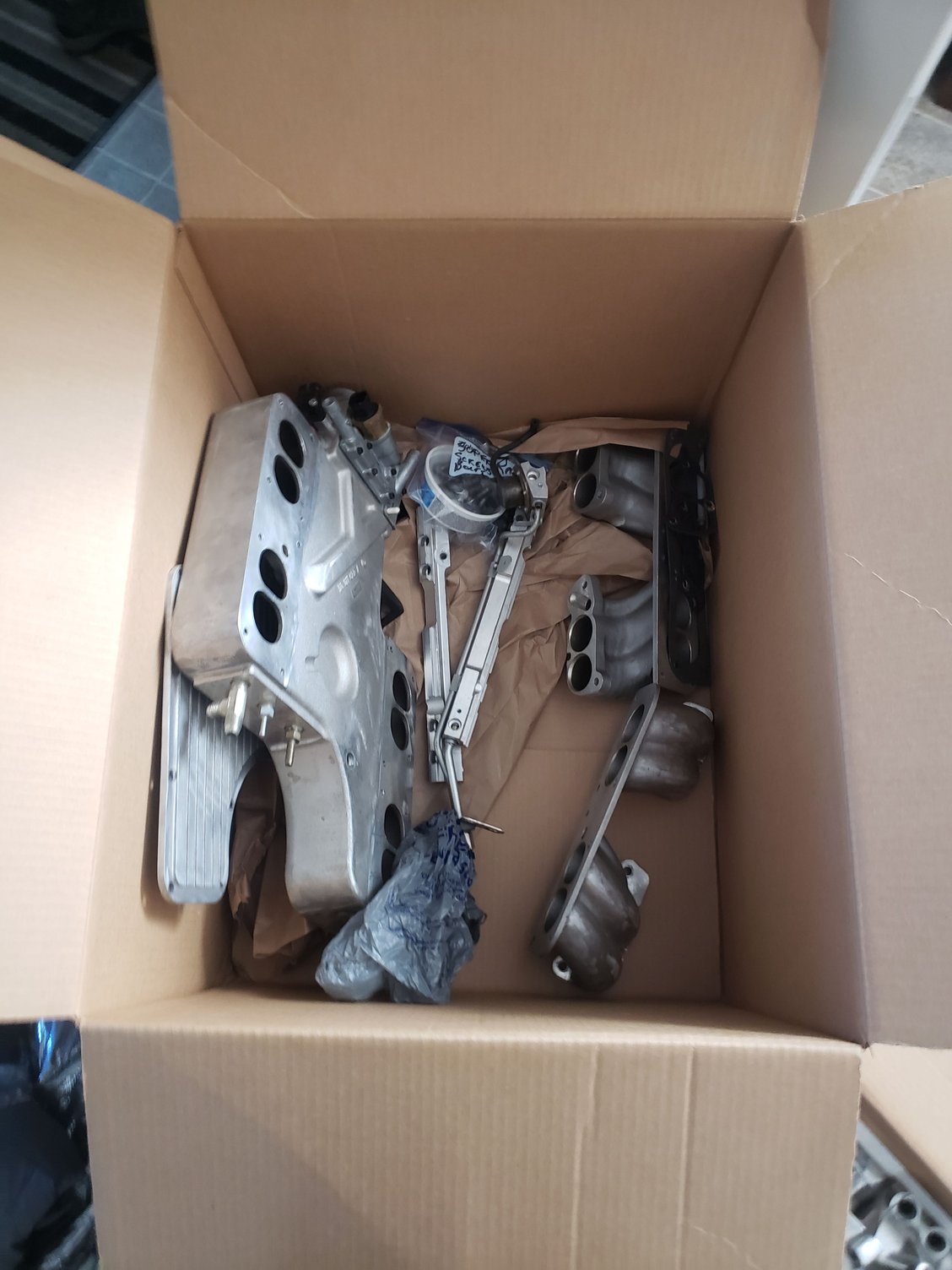

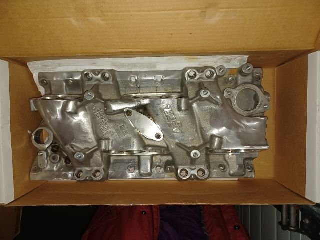

Open the manifold box to make sure its really a victor intake. Maybe youll get lucky and he put the accel manifold in there.

id love to but I'm out of town working for the next month. I will get my wife to do it tomorrow and send me a picture i hope to God its the right base. So if its not anyone know what I need to purchase??

Well my wife absolutely hates me right now for waking her up hahahaha but yeah the guy that sold it to me put it in a different box it is the correct manifold thank **** and here i was telling my co worker I was going to drive to this guys house and boot stomp him
