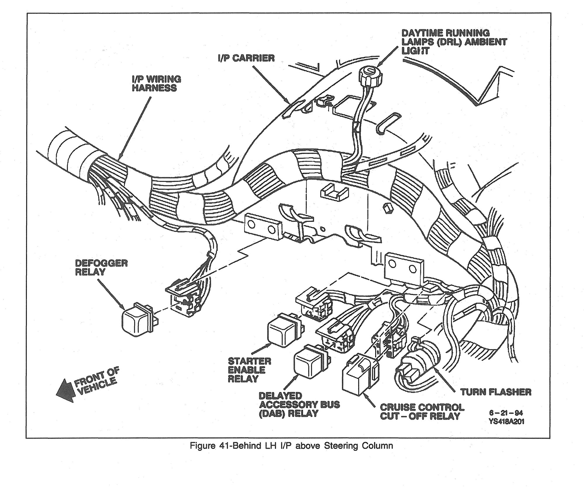

Where will I find the relay for the rear window defrost grid on my 95?

In the FSM 8A-201-24 has a very good image of location. Do you have FSM?

Originally Posted by CorvetteRules
Had one for the 91, but haven't bought one for 95 yet.

That is perfect, thank you. I tried to find information online about it but found nothing regarding location, only places could buy a replacement. Guess I have to stop being lazy and get FSM. Been putting it off because 95 has had next to no problems with only the 02 sensor going bad and my scanner pointed it out.Now I can pull out the multi meter this weekend and check some reading or lack of.
