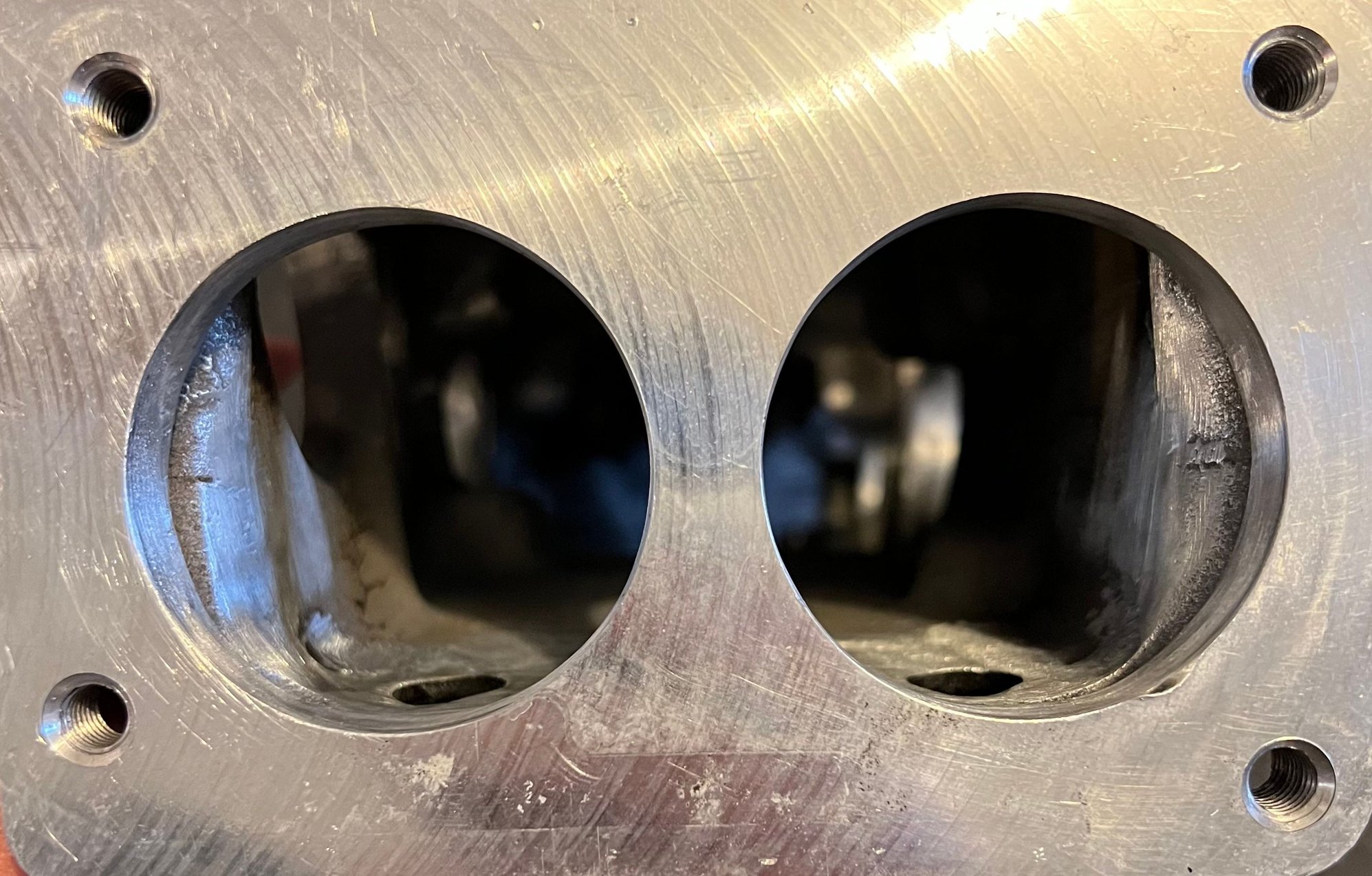

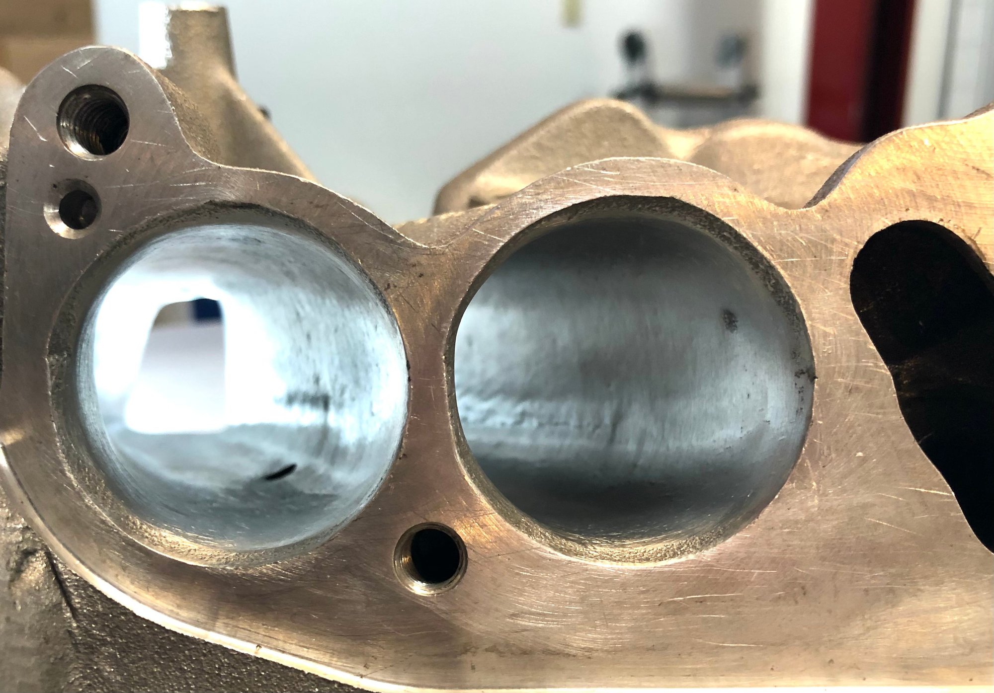

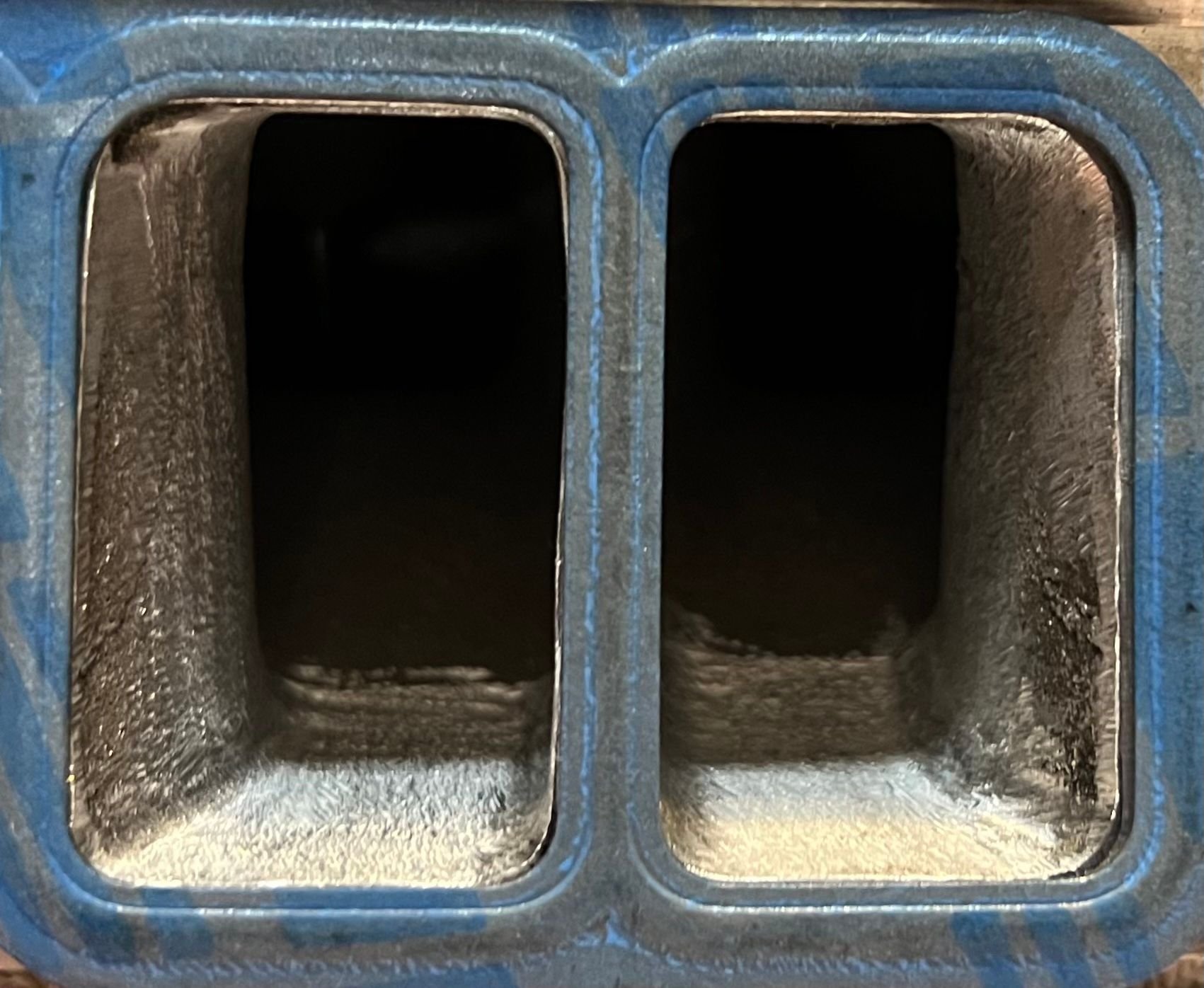

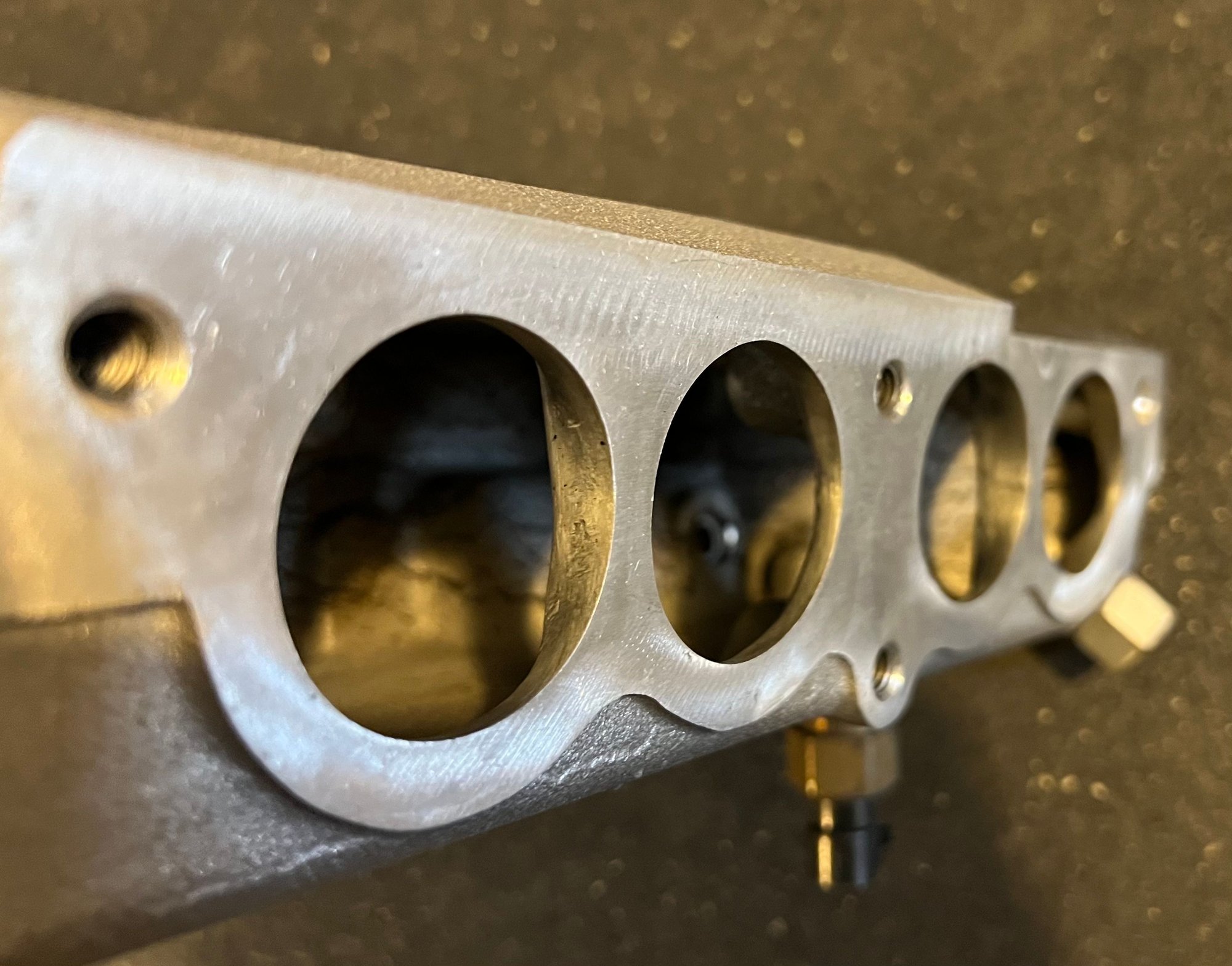

I’m evaluating my options now that the cam bearings are bad in my 72k mile 89 vette engine. I know I’ve gotta finish pulling the engine to see what the main & rod bearings look like as well as the bores & crank. So here’s my question; is there a way to make a stroker kit work with the stock TPI system for now, & then later upgrade the major components?
I know to maximize the stroker I need better heads, bigger intake, throttle body, fuel injectors, fuel pump, etc. However, if I have the short block disassembled & have to have some work done at the machine shop, I’d love to be able to do the stroker bottom end kit 1st. Put it back together & run it for a few years before doing those other needed upgrades. What say ye?
Just to let ya all know I have already done a clean up porting of the intake plenum, runners & base as well as a little bit of the intake head port entrance. So mostly stock. The cam I already have & was going to use is the TPIS Super L98 single pattern 220 dur & .427 lift w/112 lsa. I could always add 1.6 rockers if absolutely needed or perhaps get a different cam.
Thanks!
Just worked the first inch or so to even up all the head ports
Clean up & matching to gaskets
Took out the ridge on both ends & made sure gaskets matched up well
Knocked down the major obstruction at the front bottom then opened up the bores better
Cleaned it up but focused on removing some of the bend obstruction at the head side.

Yakmastermax, the pictures I posted in my opening post are of the things I e already done. Not ideal for a 383 but helpful for my original plan of just doing the cam & springs upgrade. I already have the cam sitting on the shelf & was all ready to install it until I found the bearing issue.
I guess my big concern is can & how one can do the stroke kit with the stock heads & the intake as I have it now (pics in 1st post). Will it need an ecm worked on? Can I use the new “stock” fuel injectors I already have? Are there specific things that no matter what I’ll need to do to get it to run?
