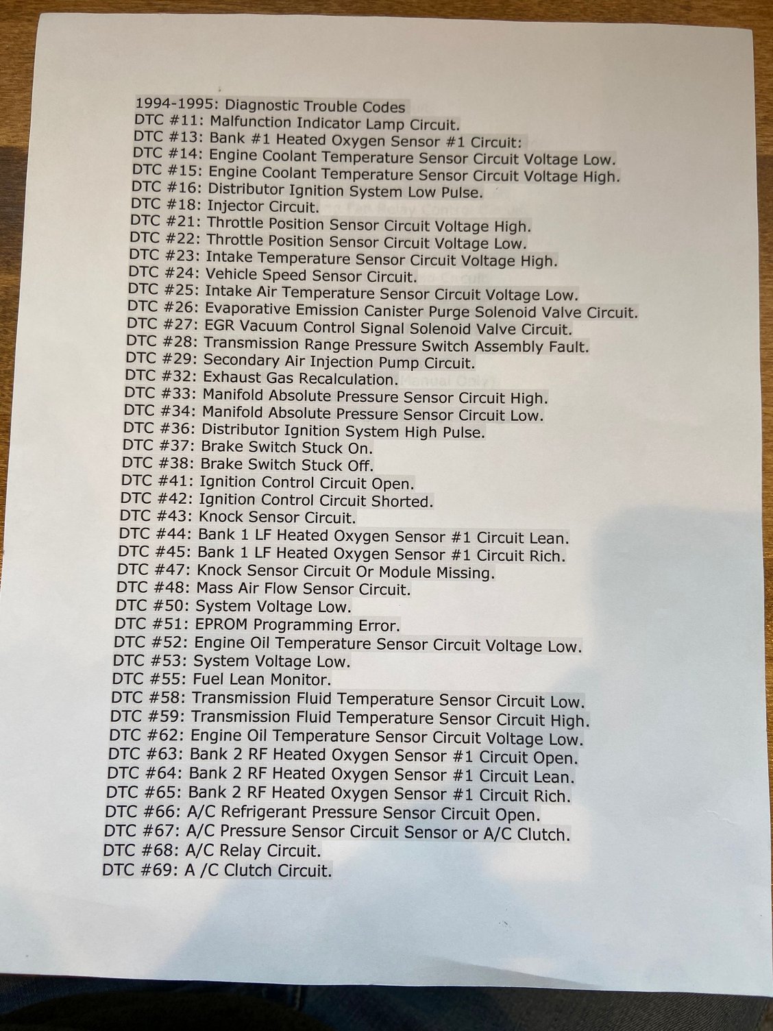

You and I are in a very similar situation! I just picked up a ‘95 with a 6-speed and unknown service history. Mine is hesitating/sputtering under heavy acceleration after warmed up. I’m currently working on replacing O2 sensors, plugs, and wires based on it running rich as well as throwing a few codes.
Here’s an explanation for the codes.

Hold on, this a a very incomplete guide and missing a lot of critical info.
It is extremely important you know which MODULE the DTCs are from before you can search up on what they might relate to.
