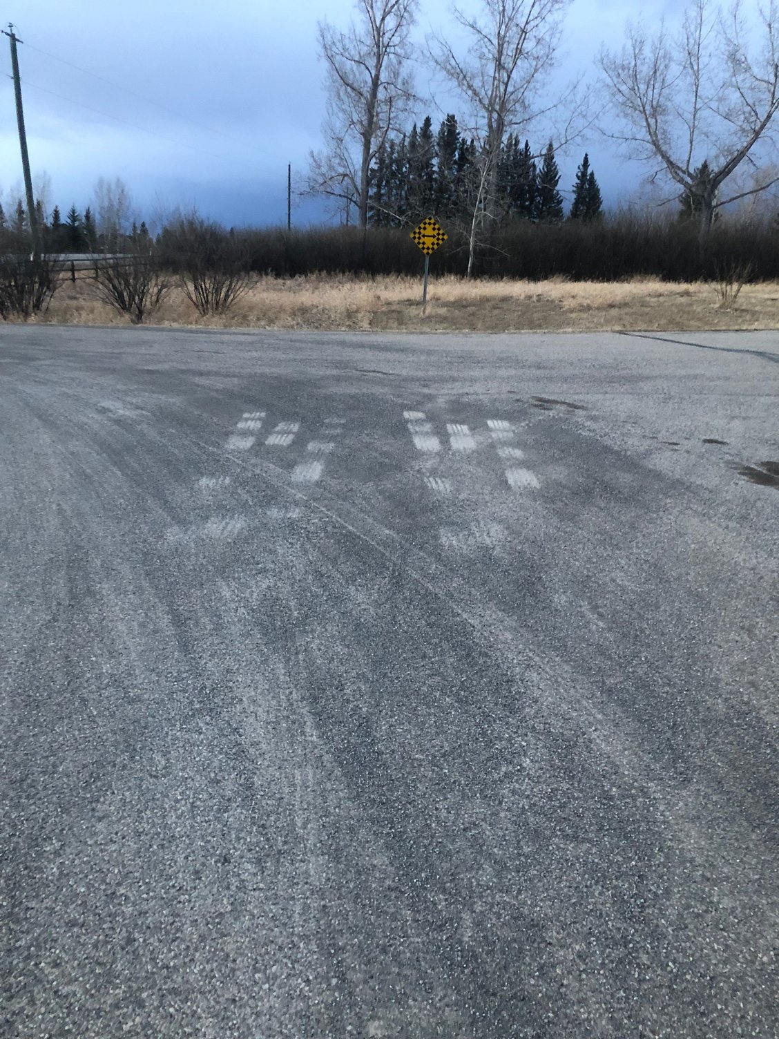

i did it today just to capture pic and share it
this was in a 99mn6 but u get the idea.

Thanks for the pic. Once I sort out whatever's going on with the wheel speed sensor, I'll take the car out and do this and see if we get any different results when bleeding.

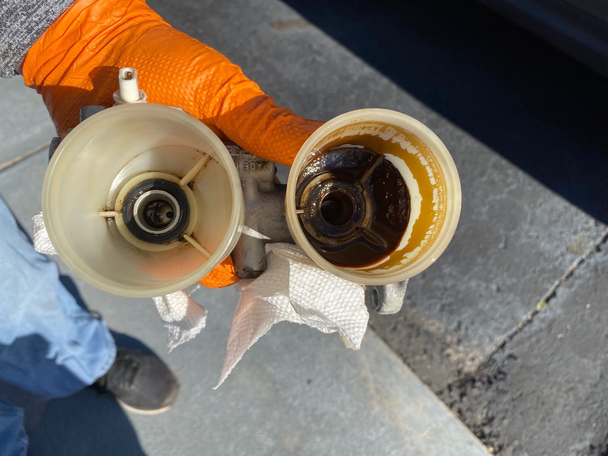

To be fair, there was A LOT of crud in the original fluid reservoirs, so I don't find it impossible that it trashed some seals internal to the ABS somewhere. For example, here's a pic in the middle of it where I had cleaned out one of the reservoirs and you can see the stark contrast with the condition of the other:
