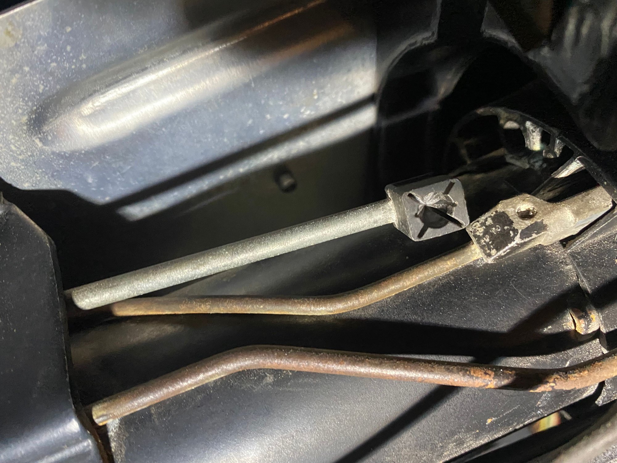

Here is a picture of the mechanism under the steering column.
Here is the mechanism of my under column area. For orientation, the front of the car is to the left, the steering wheel is to the right. I see three metal rods. From top to bottom. The top is not connected and the square piece with the round opening is not connected to anything. When I turn the key the middle rod (the one with the slight bend upwards) moves back and forth. The bottom one does not do anything when i turn the key
I have not yet tried to turn off the car by sliding the rod. I wanted to make sure I understand the anatomy first.
What do you all think I need to do now?
Charles

You got it!! Did you have someone turning the 'KEY' with battery disconnected while you watched? The upper in your snapshot that's NOT connected is the 'park lock cable'. Shouldn't have anything to do with your issue. The middle rod if while you watch and someone rotates key should move, the lower is 'dimmer' that if connected correctly you should be able to see move also if lever is lifted. You mentioned it moving so if battery connected and the car 'CRANKS & RUNS' but won't shut off moving the rod should 'SHUT DOWN' if the upper column parts (rod you see upper rack you can't see) are correctly attached. You're very close to what's needed for an ignition switch switch replacement. Is the switch maybe loose on the column mast jacket?

You answered your own question, as you said the bent one moves with the key (ignition rod) you proved the rack/gear works. So now pull the switch off the column, the rod has a bend at the end that fits in a hole in the switch you can stick a nail/small screwdriver in the hole and manually test switch for it's functions. It should feel knotchy click through functions, loose no effort probably means bad switch. You have it in hand anyway and they are cheap.
