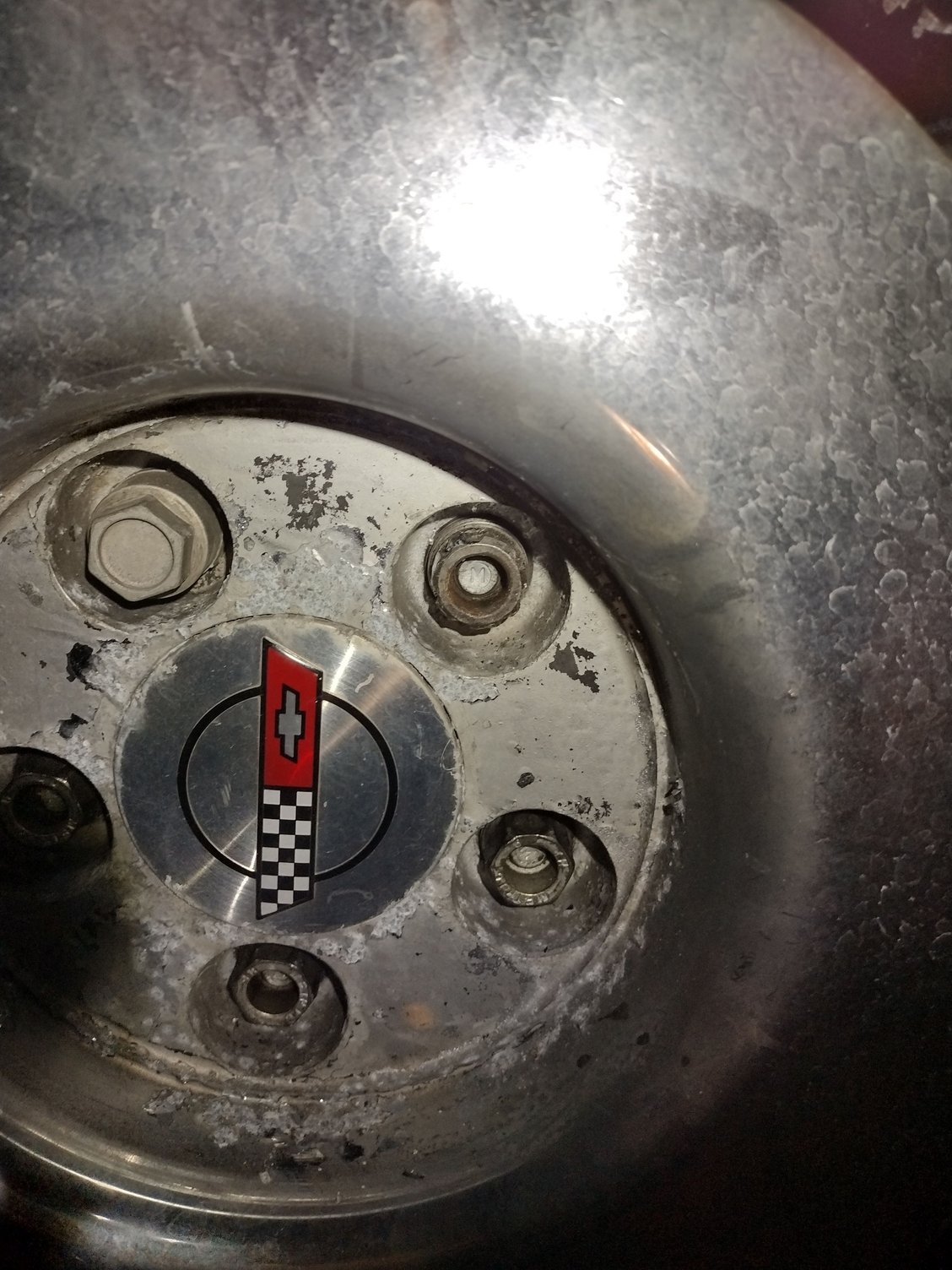

Default Locking lug nut key
I hate them! Can anyone identify which one I need? I did a search on here and found the amcor website. I can't tell which one I need. It's off a 85 project and I don't have the I'd card. I only have the vin if that matters.
Appreciate the help!

Thank you all for the replies, but I would like to get the right key. I am not in too much of a hurry to remove it and would prefer just getting the right key.
Old Apr 4, 2022 | 03:05 PM
WVZR-1's Avatar
WVZR-1
Joined: Sep 2003
Posts: 25,394
Likes: 2,741
Take as 'detailed' an image as you can and send it to Amcor. The snapshots in your original aren't what they'll want! Their images in their web presentation do 'expand/zoom' I believe.
Old Apr 4, 2022 | 03:08 PM
topfuel67's Avatar
topfuel67
Joined: Feb 2016
Posts: 1,384
Likes: 339
From: Simi Valley CA
I'll try that. I might even try making a clay mold. They have good images of the sockets, but bad angles on the lug nuts themselves to compare to.
