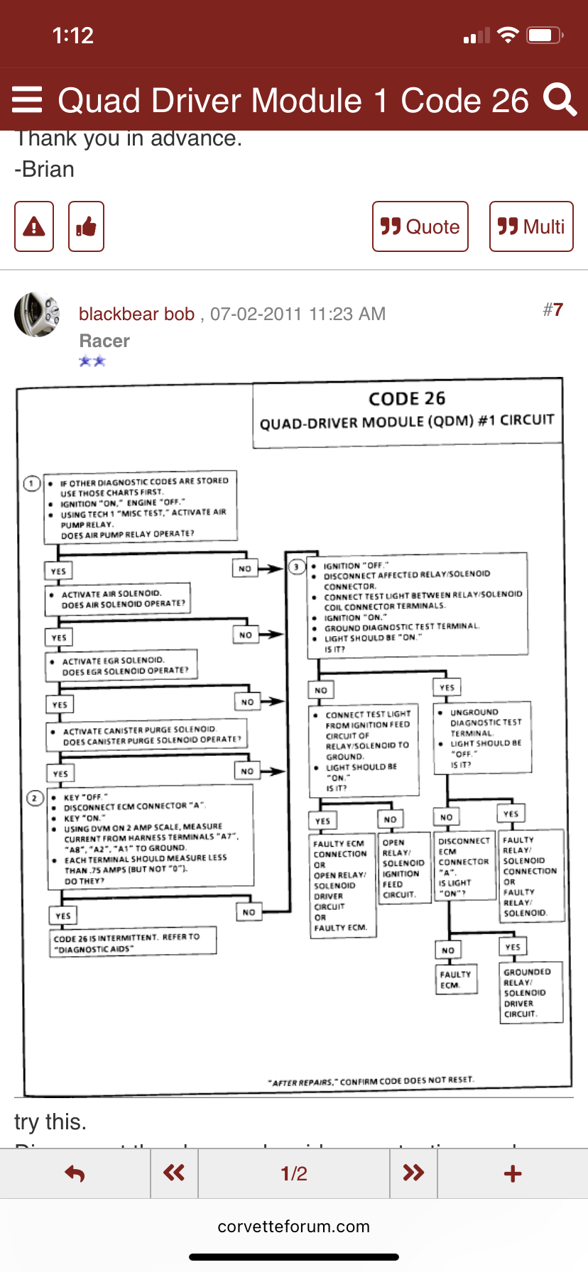

Here’s the diagnostic chart for h26 code from FSM. I searched for 92 corvette h26 codes on google and found info that some people found the egr solenoid checked fine when cold but not when it was checked hot and it set the h26 code. If everything else checks out and you believe it’s the EMC you can send it to SIA Electronics and they w
ill reflow the solder joints. 92-93 EMCs have had problems with their solder joints.
edit: I don’t know how to get the image to post larger for you. I’m using my phone. You can find the info by searching google for 92 corvette h26 codes.
