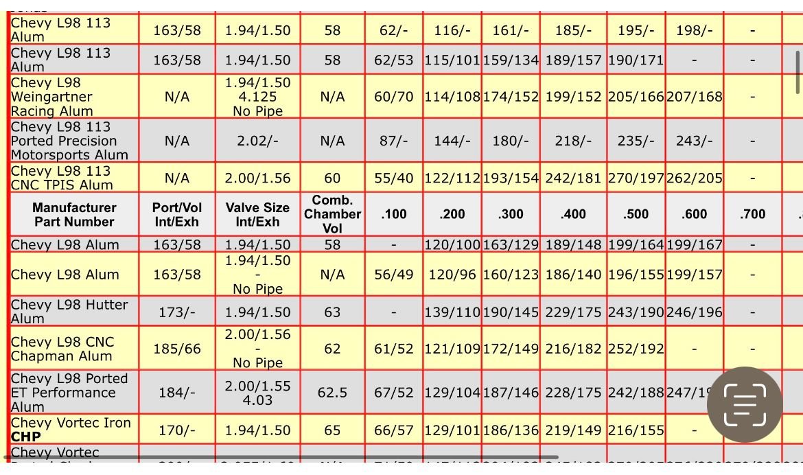

I’ll throw this out there, if finding heads becomes a huge PITA you may give Jim a call @TPIS. See what his recommendations are and there’s always the ability to have him CNC the 113’s from your 89 for around $1,500.

was browsing lpe site, and they also still do the 113 castings. for guys wanting a period correct nostalgic build, or to duplicate his 50 state emissions legal packages from back in the day its an option if you need to keep your car numbers matching etc. but 1500 for cnc porting an inferior head to flow less than an out of the box 180-195 afr that costs 1900 doesnt make much sense, unless you have emissions testing, and or the need to use a stock head for a certain racing class.

113 heads not worth sinking the money into..back then there werent a ton of options. Larger valves, new seats, porting, machine work etc it adds up and you still got an antiquated combustion chamber, port and thinnish deck.
John used the older AFR 190 castings often which ran real well. Those castings were frigging heavy lots of room to grow.
Like the AFR 190 Vortec head would love to see a build with them...would be awesome for something like this
Member here made around 480 to the ground with a 383 super ram combo.
Mike Jones cam, AFR 195 st heads with a little work done to them, intake was maxed out....ran bottom 11s due to traction issues that car was a monster for what it was.
Personally a fan of single pattern cams if one has a nice exhaust system and good flowing port...that crower 221 cam is nice.
Have a set of the same heads (casting anyways) as the Enforcer they are capable of 300 plus cfm with a 2.02 valve....just collecting dust.
AFR uses a ductile iron seat rather than powdered metal and of course as mentioned hardware. Their flow #s are probably on their site. Id guess 250-260
Lots of ways to skin the cat...not starting a debate but sold on a steel core rather than iron.
. Anti fast ramp guy here...some love em others not so much. Bitten a few times by them, not for me.
Different strokes. Be weary of cheapy aluminum heads online there are lots of foundries and god only knows what they are pumping out. Zillion different brands for the same head with crap hardware.
Think the 195 st head would work good for you.
