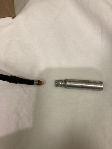

Default Does anyone know how to fix the end of the antenna cable?
In attempting to replace my 1987 Antenna i pulled the cable out of the end where the antenna connects near the read left speaker. Can this be repaired and if so, how to go about doing so?
